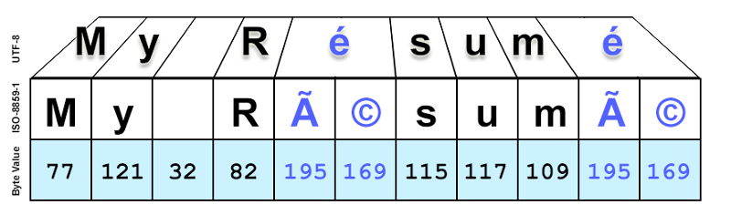

Single-byte encoding, like ASCII or ISO-8859-1, simply treats every byte as one character. If that character is not a normal printable character, then some gibberish character would show up. For example, some of the first 32 control characters will show up as a music symbol or a line corner, or the male or female symbol.
UTF-8 encoding is the most common multi-byte text encoding out there, and it acts like the kid who is jumping over the puddles. When an application tries to read a series of bytes as a UTF-8 string, it starts by reading bytes one-by-one, just like ASCII. In many cases where there are no multibyte characters, it may act EXACTLY like ASCII. However, it is also paying attention to the byte value each time.
If the byte value is within a certain range (128 or higher), the application gets a signal to take a closer look at the byte. If that byte's value is between 192 and 223, then that tells the application that it's dealing with a 2-byte character, so there should be one more extra byte. See the example above, where the first byte with a value of 195 tells the application that there's one more byte (169). If that first byte value is between 224 and 239, then it's a 3-byte character, so there should be TWO more bytes to read. If the byte value is 240 or higher, then it's a 4-byte character, so there will be THREE more bytes to read. There are also some rules on the values of the extra characters, but the first byte is the one that tells the application how many bytes to read in order to assemble that one character. Once it reads in all the bytes for a character, it looks at their total value and then finds the correct Unicode character to display for that value.
As soon as it finishes with that character, it goes back to the one-by-one byte reading, and keeps repeating that whole process until everything is read.
If someone used an application to try and read a UTF-8 encoded file as if it were ISO-8859-1 encoded, then they'd likely see some bizarre characters show up, because the application would be treating those special UTF-8 control characters as if they were simply the choice some weird author decided to take when he wrote the file.

At the very beginning of the article, I mentioned some confusion around PHP's functions for utf8_encode() and utf8_decode(). The motivation for writing this article was because some PHP developers don't understand what these functions are actually doing, leading to incorrect usage and sometimes, data corruption or loss! There are also other similar languages and routines in other languages.
Once Unicode was invented, it occasionally stored some of those extra ISO-8859-1 characters in different spots. For example, the symbol for Japanese yen is actually a single byte in the ISO-8859-1 encoding and uses the byte value of 165. This means that if a file is saved with that ISO-8859-1 encoding, then it can store that symbol in just one byte. Great, right?
However, that same character is stored in a different place within the Unicode table. So if you put the yen symbol into a file and save the file with UTF-8 text encoding, it would actually use two bytes when saving the yen symbol - the first byte would have a value of 194 and the second byte would be 165.
Of course, you can only choose one encoding for text, so if you had a sentence that was encoded with ISO-8859-1 and used the yen symbol, then you would probably run into problems if you tried to give that text to some system or program that was expecting to receive UTF-8-encoded text. It wouldn't be entirely sure what to do with that yen symbol. Many, but not all, systems will use some extra programming logic to automatically figure out how to respond and will convert the encoding on-the-fly. If a system doesn't do this, it might just throw up its hands, claim it's the end of the world, and spit back an error.
So programming languages will usually have a way to convert between encodings. PHP has several different methods, and it even has some special extensions for doing nothing but handling multibyte encodings and converting between them all. One of the most common requests is this conversion between ISO-8859-1 and UTF-8, so this is where the utf8_encode() and utf8_decode() functions come in (or if you use another language, it probably has its own set of functions that work the same way).
Most of these functions aren't smart enough to be able to tell what kind of encoding is already in place, so it's up to you to either know or to figure out (again, using tools to detect the encoding if you're not sure). Knowing what the encoding currently is - that's the key to using your programming language's text encoding functions correctly.
In PHP, the utf8_encode() function will take a string of text and assume it is encoded as ISO-8859-1. It will then look for any characters that are in a different location in the Unicode table. If it finds them, it swaps out that old single-byte character for the UTF-8 bytes that correspond to the same character in the Unicode table.
So if you passed it the single-byte version of the yen symbol (from ISO-8859-1), like this:
$utf8_yen_symbol = utf8_encode(chr(165));
...then $utf8_yen_symbol would be a string containing two bytes (194 and 165).
You would use utf8_decode() if you were heading in the OPPOSITE direction. Let's say you are exporting data from a system that uses UTF-8 encoding and you are trying to store the data into a system that only supports ISO-8859-1 text. Running utf8_decode() on text would see the two-byte yen character in the original data, and it would try to find the equivalent character for ISO-8859-1, and would then swap out the two-byte version for the one-byte version.
Because UTF-8 is capable of 4 billion characters while ISO-8859-1 is only capable of 256 (sort of), you can't always go in that direction without the chance of losing data. If utf8_decode() can't find a corresponding character in ISO-8859-1, it'll simply replace the multi-byte character with a simple question mark.
If that didn't make you do a double-take, then nothing will. Yes, utf8_decode() will DESTROY any data that it cannot convert from UTF-8 to ISO-8859-1. It will preserve only the characters that it CAN convert successfully, so you might end up with a paragraph of text that has more question marks in it than you remember. And once it's been converted to a question mark, you can't use utf8_encode() to convert it back to the original value, because the question mark is actually a valid character and is the same in both UTF-8 and ISO-8859-1.
converting_between_iso88591_and_utf8.pngAlso, if you already have text with multibyte characters that is encoded as UTF-8, and you run utf8_encode() on the string, it will likely end up adding extra garbage characters into your text, because it starts with the assumption that the text is currently in a single-byte text encoding. So it will ASSUME that all of the bytes in those multibyte characters are actually individual characters from ISO-8859-1 that still need to be converted to UTF-8. D'oh!
So knowing the original text encoding is essential to knowing whether you need to use a UTF-8 encoding or decoding function, or whether you don't need to do anything at all!
