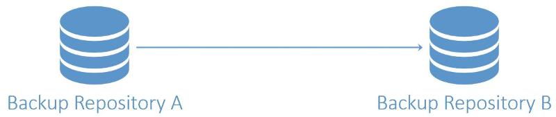

The simplest and most reliable way to protect all your backups is to create and maintain a mirrored copy of your primary Backup Repository. Think of it as of Backup Repository replication: all backups and recovery points that appear in the Backup Repository A will be automatically sent to the Backup Repository B:

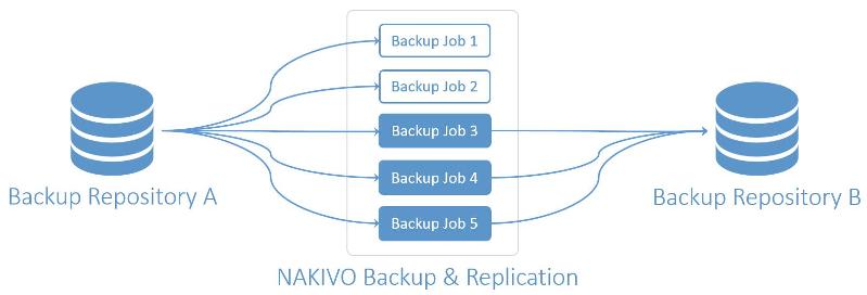

1.jpgHaving a mirrored copy of your primary Backup Repository provides a “set it and forget it” approach for protecting your backups – just create a Backup Copy job once and it will keep your secondary backup repository up to date with all backups and recovery points created by all jobs. The downside of this approach is that your backup copy will occupy a lot of space. To save storage space on your secondary Backup Repository and to speed up data transfer you can choose to copy backups made by particular jobs that back up your VIP VMs:

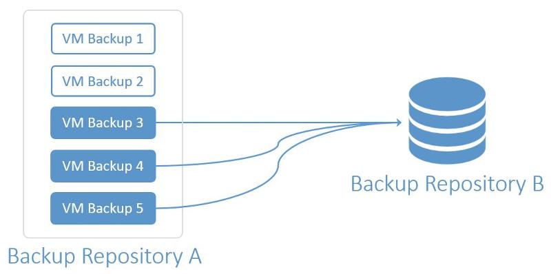

2.jpgAlternatively, you can create a Backup Copy job only for the most important backups:
3.jpgThe downside of this approach is that you’ll need to remember to create backup copies for any new VMs that you back up, so it’s best to use this approach only for special cases – like long term archival for backups of decommissioned VMs.

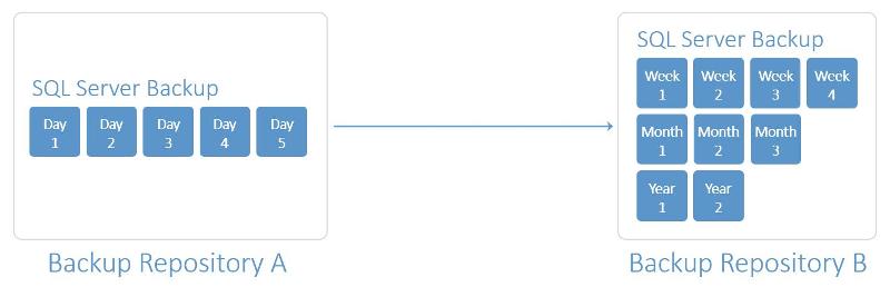

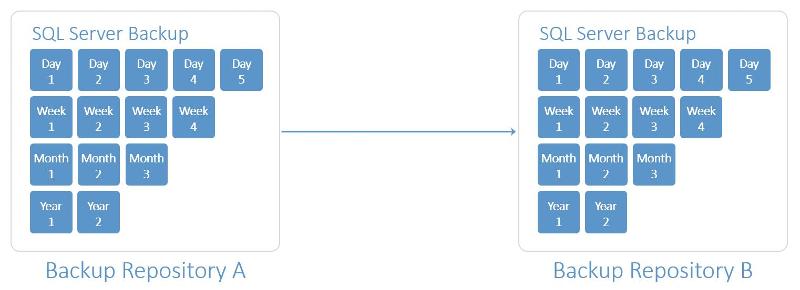

Each VM backup contains a number of recovery points, which are saved based on recovery point retention policy, i.e. how many recovery points you want to have and for how long you want to keep them. With Backup Copy jobs, you can choose to create a mirrored copy of each backup: all recovery points that are available in Backup Repository A will be copied to the Backup Repository B:
4.jpgAgain, this is the most reliable way to keep your data, but it consumes the most storage space. You can choose to set a different retention policy for your VM backup copies. This way, for example, you can keep several daily VM backups onsite, and keep (archive) weekly, monthly, and yearly copies of VM backups in a secondary Backup Repository for long term storage:
5.jpgAlso, you can use a fast storage for a subset of backups and use a slower but more reliable storage for long term archival.

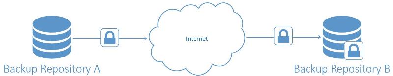

While you can keep the copies of your backups locally, having at least one copy of your most critical backups offsite can save you from a lot of trouble in case a local disaster wipes your infrastructure. When sending backup copies offsite, it is important to enable in-flight data encryption and encrypt the secondary backup repository if it’s location is less secure than your primary one:

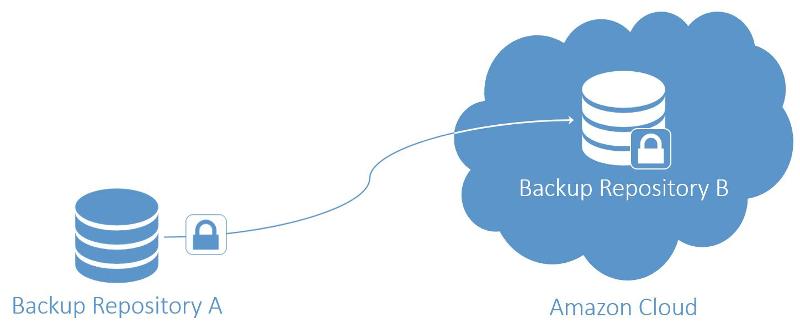

6.jpgIf you don’t have a secondary site, you can send your backup to Amazon cloud, which provides one of the most reliable and affordable cloud services in the industry:
7.jpgBackup Copy jobs provide a powerful way to protect your backups and ensure that they are safe no matter what happens to production environment or primary backups.
