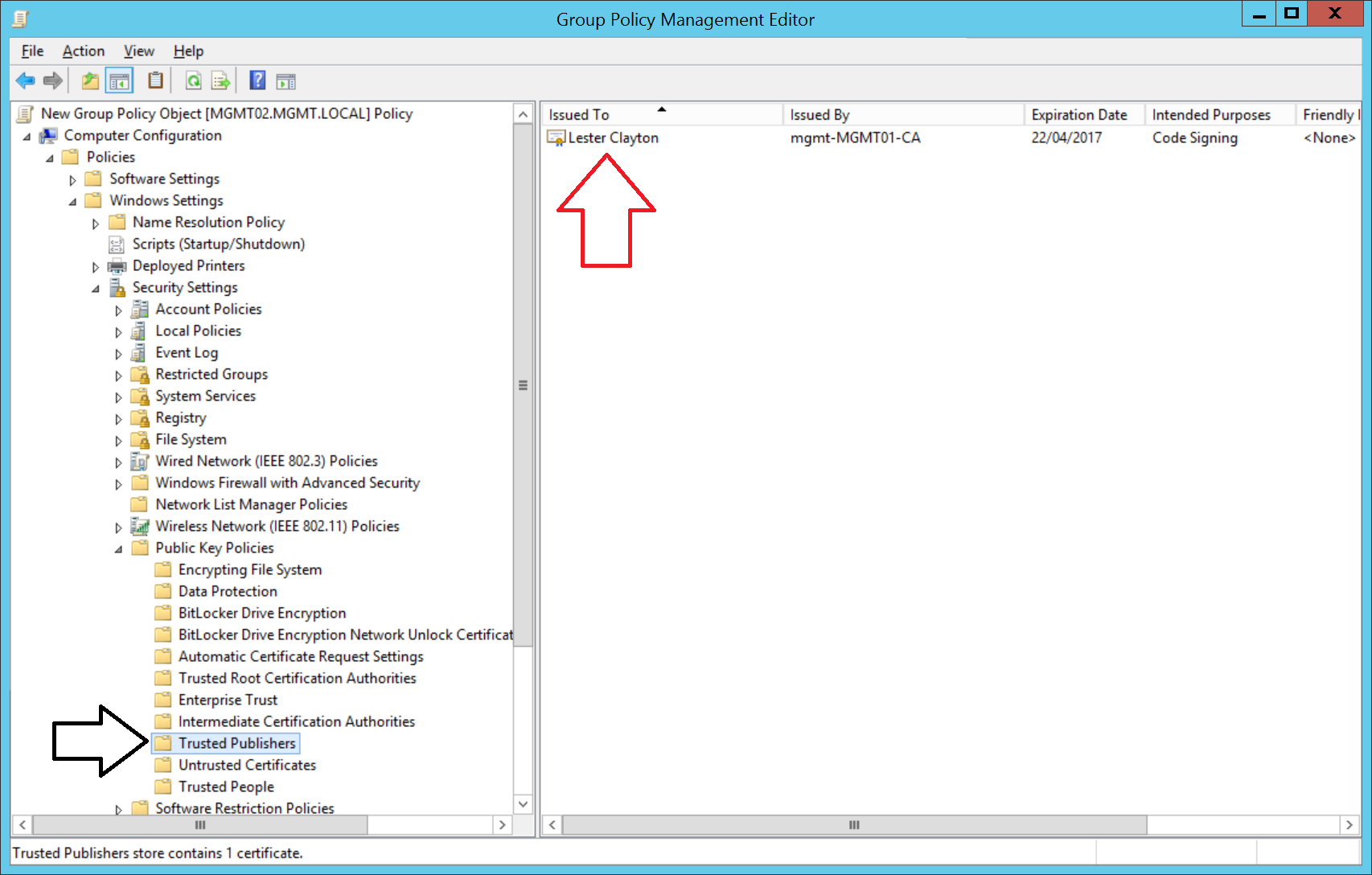

Automating Trusting Code Publishers
Of course, we don't want our users to be nagged by these prompts.  Using a Group Policy Object, it is possible to pre-install certificates for users inside an Active Directory Domain.  The GPO would look similar to this:

Thank you for your compliment.  Yes, you can use an internal PKI, however it's not enough to trust the root certificate - users still have to trust each developer.  You can automate this via GPO, just look at the "Automating Trusting Code Publishers" section above.

yes i have since added myself (publisher) to trusted publishers from the gpo and it works perfectly.
