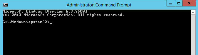

1. Open an elevated Command Prompt.

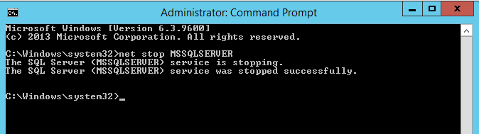

Admin-Cmd-Prompt.png2. Stop the SQL Instance.  The default is MSSQLSERVER.
net stop MSSQLSERVER

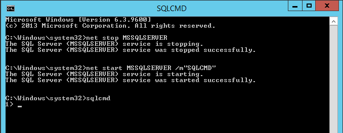

net-stop-mssqlserver.png3. Start the SQL Instance using the '/m' switch and specifying you'll use SQLCMD to interact with the instance.  The input following the '/m' switch is case-sensitive.  There's no indication you're connected in Single-User Mode, so don't worry if you don't see anything.
net start MSSQLSERVER /m"SQLCMD"
4. Connect to the instance with SQLCMD.  Just type 'sqlcmd' and hit <ENTER>.  You'll find yourself at a numbered prompt.  This means you're connected to the default instance.  If you want to specify a particular SQL instance, just use the appropriate SQLCMD switches.  The syntax will be:
sqlcmd -SServerName\InstanceName

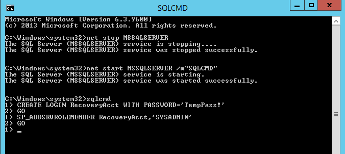

5. From here, you use Transact-SQL (T-SQL) commands to create a login.  I'm going to create a login called "RecoveryAcct" and give it the password "TempPass!".  Since you're issuing T-SQL commands directly, you'll need to use the 'GO' command, too.  There's no indication the command was successful; you just end up back at a '1>' prompt.  If you don't get an error, you can assume all is well.
CREATE LOGIN RecoveryAcct WITH PASSWORD=’TempPass!’
                      GO
6.  Now, use more T-SQL commands to add the user to the SysAdmin role.  Again, you'll need to use the 'GO' command and if you don't get an error, you can assume all is well.
SP_ADDSRVROLEMEMBER RecoveryAcct,’SYSADMIN’
                      GO
sqlcmd-add-role.png7. To exit SQLCMD, type 'exit' and hit <ENTER>.  Next, stop the SQL instance and then start it again without the '/m' switch so it is no longer in Single-User Mode.
