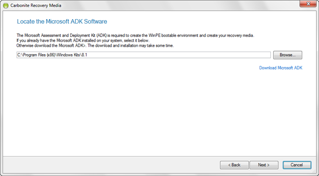

rmwizard_mountshare_50.pngYou are then also prompted to list the location of the Windows Assessment and Deployment Kit (ADK). The Windows ADK is what is used to facilitate the bare metal recovery process and needs to be installed on the computer you are building the recovery media on before you can continue. If you already have the software installed and listed in the field provided, please click Next to proceed to building the recovery media. Otherwise, please click Download Microsoft ADK to be taken to the Microsoft Website. If you are having difficulty downloading the Windows ADK, please click this link http://www.microsoft.com/en-us/download/details.aspx?id=39982 to download it.
rmwizard_adk_50.pngWithin the Microsoft page, click Download to download and then run the ADK installer. The Assessment and Deployment Kit will run and you will be prompted to select a location to install the ADK. Click Next once you have selected this location.

rmwizard_adk_installcomplete_50.pngNow that you have the Assessment and Deployment Kit installed on, please make sure that the path is pointing to the correct location. If not, please click Browse and navigate to where you installed the ADK. Otherwise, click Next.
