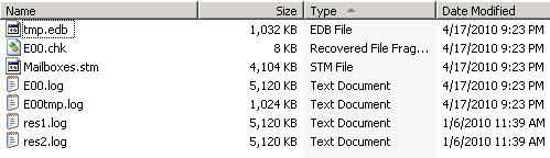

8. Check logs directory and verify log sequence has been reset
Verify log sequence

4. Verify the log sequence has been reset
Verify log sequence2
