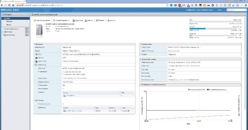

You may have noticed that on enabling both Remote SSH and the ESXi Shell for management of hosts from the vSphere VMware Host Client and from the Direct Console User Interface that a
Configuration Issues warning yellow box appears on the Summary page of the host ESXi server.
This
Configuration Issues warning yellow box only appears when Remote SSH and/or ESXi shell has been enabled.
If you are also connected to a Windows vCenter Server using the vSphere Client, you will also notice there is also a
yellow/orange warning triangle displayed on the host server.
There is no vSphere ESXi configuration issue, VMware vSphere Hypervisor (ESXi) and VMware vSphere vCenter server are indicating there is a possible security issue with your installation, you may not be aware that SSH and ESXi shell have been enabled.

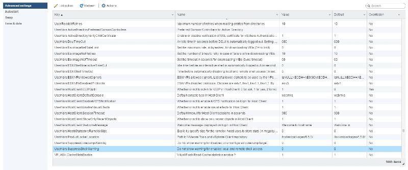

Select Host > Manage - Click Advanced Settings
2. Navigate to the UserVars variable
Navigate to and Click the UserVars section, by using the scroll bar - downwards.
Set the value of
UserVars.SuppressShellWarning from 0 to 1,
Click Save.
The value will change from 0 to 1.
The Configuration Issues yellow boxes in the Summary Page and Warning Triangle will disappear immediately.
Congratulations, you have successfully suppressed the SSH Remote Accessa and ESXi Shell warning alerts displayed in the Summary status for VMware vSphere Hypervisor 6.5 (ESXi 6.5).
