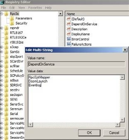

Open the registry editor by typing “regedit” in command prompt. Locate the path: HKEY_LOCAL_MACHINE\SYSTEM\CurrentControlSet\Services\RpcSs
Add a “Reg_Multi_Sz” with the name as “DependOnService” then add “Eventlog” to the data list “DependOnService”, close the registry and reboot the server in normal mode.
