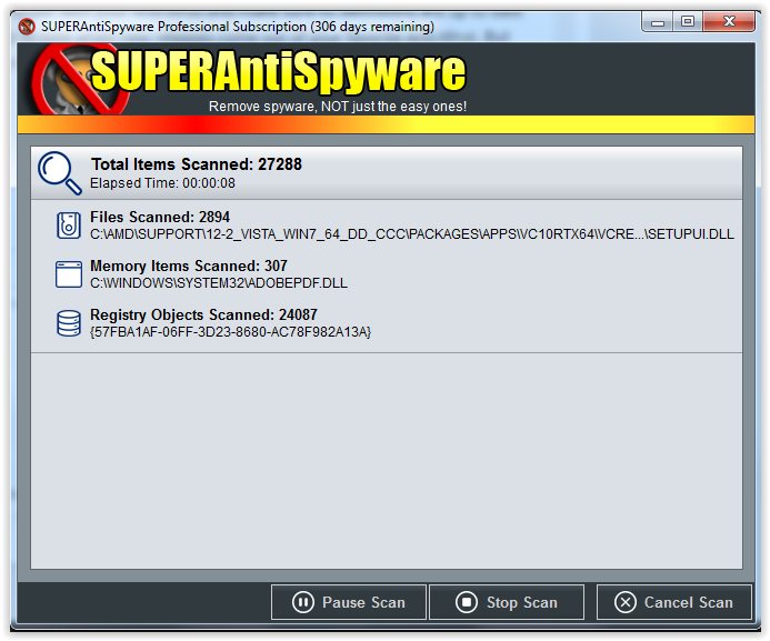

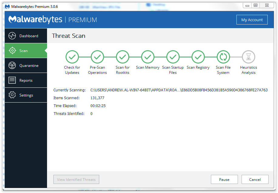

I strongly suggest using Anti Malware applications as well. My own personal favorites are MalwareBytes Premium and SuperAntiSpyware. As a MalwareBytes Premium user for many years myself, I've learned to trust it as it tends to catch a lot of things that other similar products miss. As does SuperAntiSpyware.
Here's a screenshot of both of them in action..
Both MalwareBytes and SuperAntiSpyware are available as a "Cure Only" for free, but the free versions don't protect you in real-time like an Anti-virus does. For the low price of the paid versions though, I think they're a couple of the best software purchases I've ever made. AND - both run well alongside any Anti-Virus I've tried them with, without causing any noticeable negative system performance issues and in my line of work, I've tested them both, running side by side with real-time protection enabled with many Anti-Virus products with never a problem.
