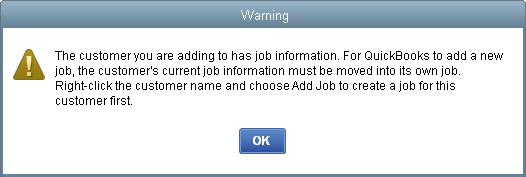

Moving a job to a customer (Sublevel zero) is done by updating the ParentRefFullName of the job. As an example, to move Job 1A to Customer #1, you simply change Job 1A's ParentRefFullName from Customer #2 to Customer #1.
That's how it's accomplished programmatically but this is not always possible even directly inside the QuickBooks interface. You can see a demonstration of that in this youtube video: https://www.youtube.com/watch?v=UivtLjJsQ1g or the video below.
Why would anyone want to move a job from one customer to another? Who knows but since it's possible, some user somewhere, and probably more than one user, will try it so you need to plan for it. Besides, ParentRefFullName is only one of several schema table exceptions.
There are a few reasons why you wouldn't be allowed to update the ParentRefFullName of a job:
To see if a customer or job has job info, open the customer in QuickBooks®. If you don’t see the job info tab, the customer does not have job info.
If you do see the Job Info tab but no information is entered for a job, that counts as no job info.

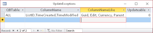

In the Immediate Window, call the above procedure by typing ExceptionsTable and hit enter at the end of the statement.
Add More Exceptions to the Table
Now that we have an exceptions table with a few basic exceptions, we can add more.
Return to the database window and the navigation pane. Open the UpdateExceptions table. The first record applies to ALL tables. You can’t update any of those fields. You can try updating currency in your QuickBooks® version and if you can, simply remove it from the table and from the procedure that creates the table.
Now let's add more exceptions.

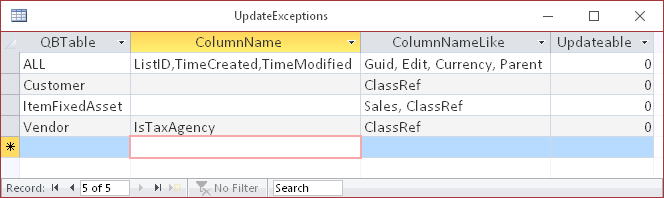

We already know some fields say updateable in the Schema table even though they aren't. Add these Fields now:

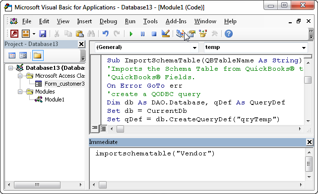

To test the blnUpdateException Function on the vendor table, we need the vendor schema table.
Since this is Part 2, you should already have the Function ImportSchemaTable so call it now from the Immediate Window.
Now test the blnUpdateException function by typing some statements in the Immediate window. That's what I did and below are the results.
The statement above returned False because the function checked the UpdateExceptions table and found IsTaxAgency so no matter what the schema table says, the Updateable value of IsTaxAgency is False as far as the database is concerned.
The statement above returned True because Name is updateable and doesn't exist in the UpdateExceptions table.
The statement above returned True because Name is Updateable in the customer Table.
The statement above returned False because “classref” is not Updateable in the customer table so we added it to the UpdateExceptions table.
