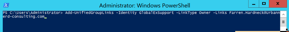

To add an additional owner to the group, the following cmdlet can be used.
Add-UnifiedGroupLink –Identity GlobalExSupport –LinkType Owner –Link Farren@ThatLazyAdmin.com

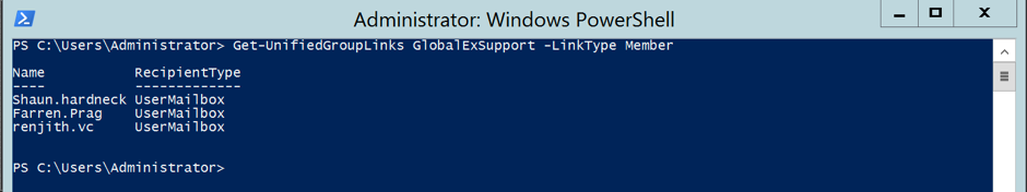

To list the group members the following cmdlet can be used.
Get-UnifiedGroupLinks GlobalExSupport –LinkType Member
