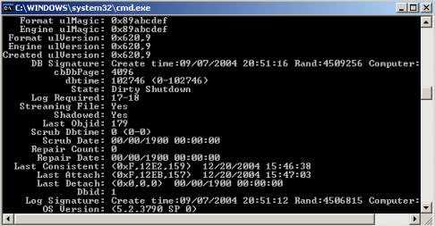

Each database file used by the store contains information about the log files it needs to become consistent.  This can be determined by using the command
       ESEUTIL /mh <path to database file>
We are interested in two lines, State and Log Required.
State -- This line specifies the database state which can be either Clean Shutdown or Dirty Shutdown:
Clean Shutdown  --  indicates that the database was dismounted in an orderly fashion or in other words it means that all outstanding transactions were committed to the database and it is consistent(no log files are needed to bring it to a consistent state).
Dirty Shutdown -- indicates that the database was shut down incorrectly outstanding transaction from log files were not committed and the database is inconsistent. The next time the store is mounted the database files will need specific log files to become consistent-without them the store will not mount.
Log Required -- this line specifies the log files needed to make the database file consistent.
State: Clean Shutdown – the Log Required line will show 0-0, meaning no log files are needed.
State: Dirty Shutdown -- The Log Required line will show a range of numbers such as 17-19. This is the range of log files needed to bring the database to a consistent state (17, 18, 19). To identify the log filenames the numbers have to be converted hexadecimal, in our case 11, 12, 13 adding the prefix to it (based on the log prefix for the storage group) E0000011.log, E0000012.log, E0000013.log.
After identifying the committed log files they can be manually erased. When you have enough space on the volume you can mount the stores.
