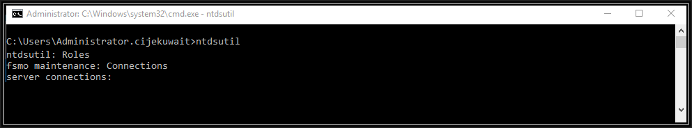

3.  Now lets seize the roles on server DC001 which is the Additional Domain Controller (ADC) as of now. Type "NTDSUTIL" and press enter from the additional domain controller.
4. Type "roles" and press enter.
5. Type "connections" and press enter.
6. Connect to the additional domain controller (running domain controller) by running the command "connect to server DC001.corp.cijekuwait.com" and press enter.
7. Press "q"  and enter to quit.

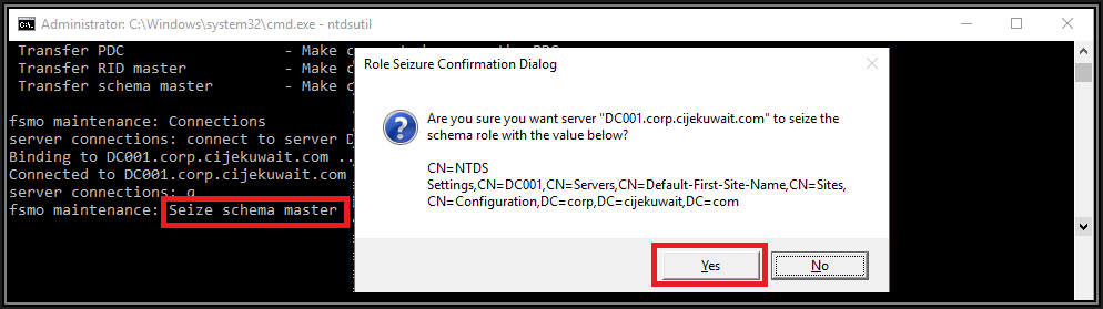

8. Lets start seizing one by one.  Type  "seize schema master" and press enter. Press "yes"  to confirm.
8.1. If seizing of schema master is completed successfully you are supposed to get a result as below.

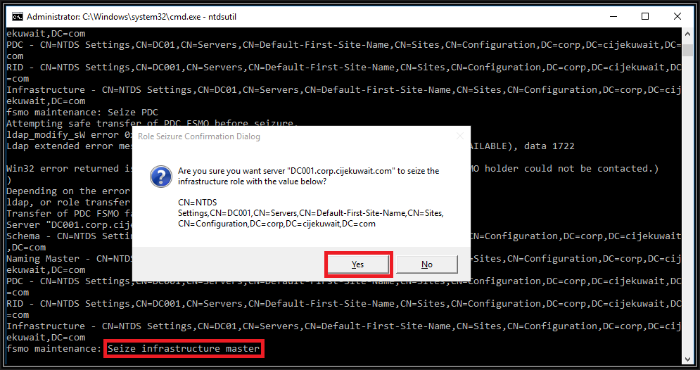

12.Type  "seize infrastructure master" and press enter. Press "yes"  to confirm.
12.1. If seizing of Infrastructure master is completed successfully you are supposed to get a result as below.
