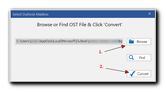

Stellar "OST to PST" Conversion Module
An OST (Offline Storage Table) to PST conversion is a very useful function if you plan on disconnecting from an Exchange or IMAP server for good, or if you want to make a local backup of your OST file. I gave Stellar OST to PST a run to see how well it would perform. Here’s how it went…
Clicking the OST to PST option presented me with the following screen.
I browsed to the location of my OST file and then clicked the Convert button as suggested.
The conversion process went a lot quicker than I expected and at the end of it, I was presented with a host of information about the contents of my OST file, and given the option to “Save Converted File” at the bottom left of the screenshot.
I clicked the “Save Converted File” and got some options about how and where I’d like to save the newly created PST file.
As you can see with the above screenshot, there are several options, but I decided to just leave everything as default and clicked the OK button. Here’s the result.
Once again, Stellar provided a helpful “How to import PST file?” instruction for those that aren’t familiar with that process. Happily, I discovered that my original OST file was left untouched and Stellar OST to PST Converter created a new file named “MyEmailAddres@gmail.com Converted.pst.”
Upon opening the Converted PST file in Outlook, I found that everything converted and mirrored the contents of my OST file perfectly. So that function too, worked exactly as I expected. A great result!

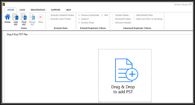

Stellar “PST Merge” Module
Next thing to try was how well the PST Merge function would work. I had a couple of PST files that I often open, so decided to merge them to see how this all worked. Clicking the option in Stellar Outlook Toolkit gave me the following screen.
I decided to try the Drag & Drop method of selecting PST files this time, so using Windows File Explorer, I highlighted the 2 PST files I wanted to merge and dragged them into the above window. That gave me the following option:
After clicking the “Next” button, Stellar went to work, did the job very quickly and asked me where I wanted to save the Merged PST files. I selected a Temporary location using “Browse” and hit the “Merge” button.
Note there are also a variety of other options available to you at this point, such as Joining PST’s as separate folder structures, which also worked well. I went with the default to just merge the two to a new PST file and hit the “Merge” button.
Another nice animation to reassure me that things were happening and once the process was completed, I got the following:
Clicking the “Open folder” link took me to a folder in C:\Temp\StellarMergePST25-Mar-2018 04.04.42 where a new Outlook.pst file had been created. I opened Outlook, loaded the newly merged PST file and started examining it. Once again, Stellar Merge PST didn’t disappoint. All the folders from both PST files that I selected to merge were there, with all contents intact, including Calendar, Contact, etc. information. Sensational result!
