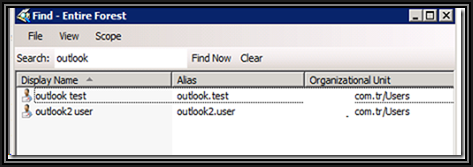

– Contacts Issue
In the target forest those two migrated users were already contacts there prior to migrating them and thus Target Forest users who have sent those two users email have the LegacyExchangeDN Address of those contacts cached in their Outlook in X500 format which will create an issue if those contacts are deleted without exporting their LegacyExchangeDN and add it to the migrated users’s ProxyAddress Attributes.
Prior to deleting those contacts, From the Target Forest, I have exported their info to CSV with the following attributes.
Name, Alias, PrimarySMTPAddress and LegacyExchangeDN Attribute using the following Powershell script
Get-MailContact -result unlimited | where {$_.PrimarySmtpAddress -like*@TargetSMTPDomain.com} | select Name,Alias,Primarysmtpaddress,legacyExchangeDN | Export-Csv c:\TargetContacts.csv -notypeinfo -encoding utf8
The PowerShell will export contacts in the following format and in order to import them you’ll need to bulk edit the file using Notepad or Notepad++
In notepad replace “/o= with X500:/o=
and Replace all “ with nothing
After you save the file in the target forest, Only in the condition of migrating Source users to the target forest use the following script to Import those users’ LegacyExchangeDN as X500 to their migrated Mailbox objects.
Import-CSV “C:\TargetContacts.csv” | foreach{Set-Mailbox -identity $_.Name -EmailAddresses @{add=$_.LegacyExchangeDN}}
