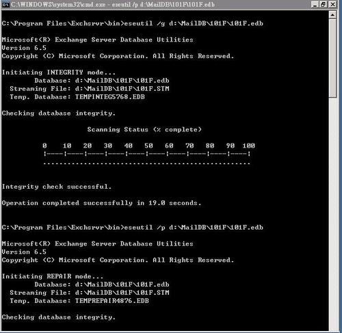

  • Type “C:\Program Files\Exchsrvr\bin” in the command prompt to find out eseutil.exe on your system.
  • Once you have located eseutil.exe, run this command to fix major Exchange corruptions:
Eseutil /p C:\Program files\Exchsvr\mdbdata\ primary name.EDB
  • After the corruptions are repaired, defragment the database by running this under command:
Eseutil /d C:\Program files\Exchsvr\mdbdata\ primary name.EDB
  • Now, close the command prompt. Then open eseutil again and run this command to check the integrity weaknesses:
Isinteg –s {Exchange Server name}-fix-test all tests
  • Now verify if the database has some specific inconsistencies by running this command:
Eseutil /g C:\Program files\Exchsvr\mdbdata\ primary name.EDB
