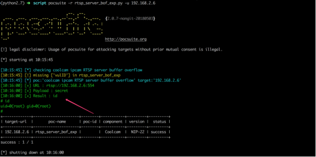

3.4 RTSP service's remote Code execution vulnerability based on buffer overflow (no Authentication required)
3.4.1 Vulnerability detail analysis
The overflow point is located at address 0x006C6D4, using the sscanf function to match key and value in the Authorization: Digest key=”value” in RTSP Header and saving them on the stack of this function. The stack is overflowed because both of the lengths cannot be checked.
3.4.2 Vulnerability exploitation analysis
The way to exploit this vulnerability is the same as the method in Section 3.2.2. The attacker can use two overflow vulnerabilities to write the instruction to be executed and the return address which can easily lead to remote code execute from buffer overflow. The results in NIP-22FX are as follows: The telnetd service of the target system is successfully opened by using the buffer overflow of the RTSP service.
3.4.3 Patch analysis
In the latest version of firmware (V7.7.4.1.1-20170828), the length constraint is added to the regular matching expression of sscanf, and the maximum of it is 255 bytes. The return address cannot be overwritten since there are 296 bytes left between buffer and stack bottom.
