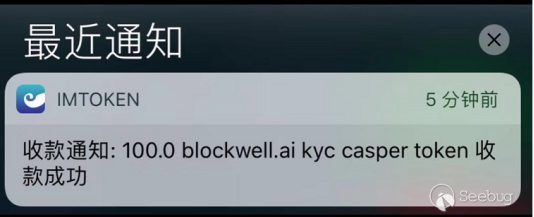

At about 1:00 am on September 7, 2018, a token transfer in/out message called blockwell.ai KYC Casper Token was received from lots of Ethereum wallet accounts:
Strangely enough, these accounts indicate that they had "nothing to know" about this Token. The users did not actually receive the 100 tokens that were prompted, and those who prompted for the 100 tokens to be transferred did not have the tokens before. All these seem "unexplained"!
What makes some people even more strange and worried is that these transfer in/out operations do not require any password or private key input from the wallet owner, so many users who do not know the truth are worried about whether their wallet is maliciously attacked.
