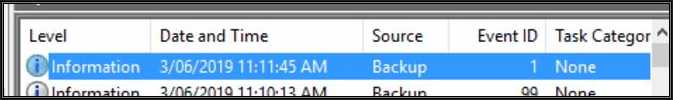

  7. We need to "create some events" in event viewer if you are doing this from scratch  on a new server.  To do this create a backup job, it only needs to be one file, so that the Stop and Start events are logged to the Event Log
    • Open Event Viewer on the server and using Event ID 1 as an example:
    • Drill down to Applications & Services Logs > Microsoft > Windows > Backup < Operational
    • Locate Event ID 1 with a Source of Backup
    • In the right hand pane of the MMC there should be an option to Attach Task to This Event
    • A Create A Basic Task dialogue will appear.  Set a meaningful name for the item.  Add a description that makes sense so make it verbose, include plenty of detail.  Click next.

    • Did you leave Testing set to on causing the batch file to pause indefinitely?
    • Did you select the correct Event ID's? - Event ID 1 from other areas such as Disk Admin won't work....
    • Could it be that for ssl usage, your mail server needs to have a port specified? Add the parameter "/port xxx" to your swithmail command (xxx is the port number)
    • If your mail server needs authentication, add a parameter "/pass youroutgoingmailserverpassword" to your swithmail command
