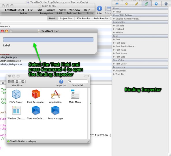

4. Set up the binding
Select the text field in the prototype window. Press Command-4 to open the Binding Inspector:
Binding. Text Field control.In the Value section check the checkbox Bind To.  Press on the button on the right and in the popup menu select the application delegate named Text No Outlet Application Delegate:
Binding. Text Field control.Type text into the Key Model Path input field.  You should see something like this picture:
Binding. Text Field control.In this step, I connected the text field in my GUI with the property named 'text' from the application delegate class in my source code.
Select the label.  Press Command-4 to switch to the Binding Inspector. Check the Bind To checkbox, set the application delegate and modify the Modal Key Path in the same way as for the text field.
Binding. Text Field control.Save your work in Interface Builder (Control-S or Save in the File menu).

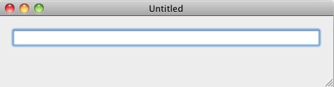

5. Build and Run the program
It will look like this:
Binding. Text Field control.Try to type a text in the text field, press Enter.  You will see the text reflected immediately in the label.
