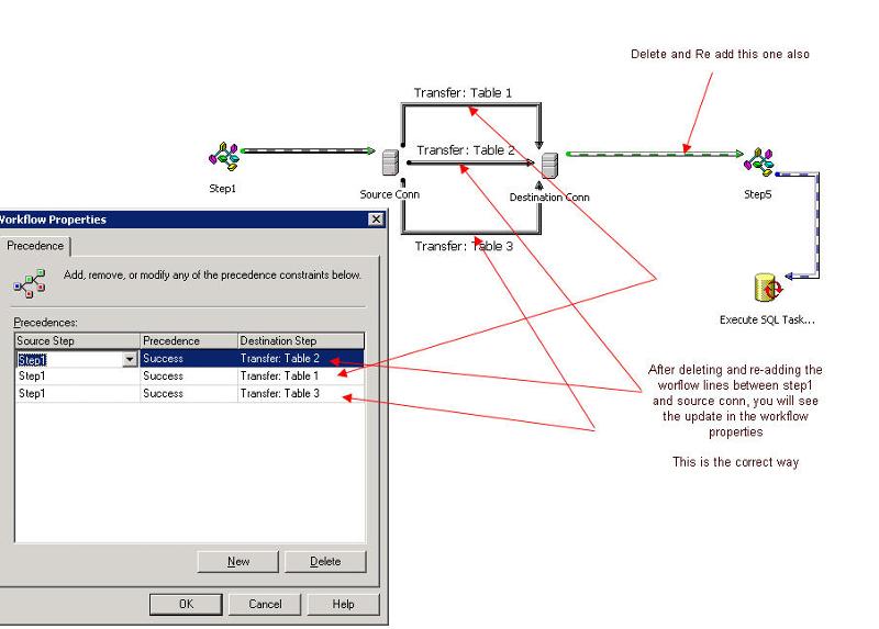

...and run the Package again.  This time, you will see the  original problem.  This is because the Workflow Lines don't get updated automatically.
5 Workflow Line not updated
The Fix
To fix this problem, all you need to do is delete the workflow line and add it again, this way it will update itself automatically.  In the case, you will need to delete both of the lines between
    Step1(ActiveX) and Source conn
...and the line between...
    Destination Conn and Step 5(ActiveX)
6 Fix Workflow lineAfter deleting and re-adding the workflow lines, run the DTS package again and you will see that it is working all correct.
7 SolvedThe checkmark in the image is to show "Done... and Done right!"
