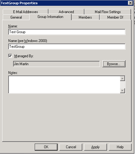

Exchange 2010 introduced the new RBAC (Role Based Access Control) model. Anyone who has already migrated or began migrating mailboxes may have experienced the issue where users cannot modify groups they could previously. There is an excellent article that describes the cause and solution for this issue on the Exchange Team site. You may have most of your users working after running the script, while others still get the dreaded error. As an administrator you may get the following error when you run the Add-DistributionGroupMember cmdlet: You don't have sufficient permissions. This operation can only be performed by a manager of the group.
Why do you as an administrator get that error when trying to add members? Why do your users still get an error trying to update their groups? If you open the properties of the distribution group and look at the Group Information tab, you will notice that the appropriate users are not present under the managed by list. One reason they are missing is the script used to grant users permission to modify groups in Exchange 2007 did just that and only that. Exchange 2007 also does not add anyone when the group is created (Exchange 2010 automatically adds the group creator).
