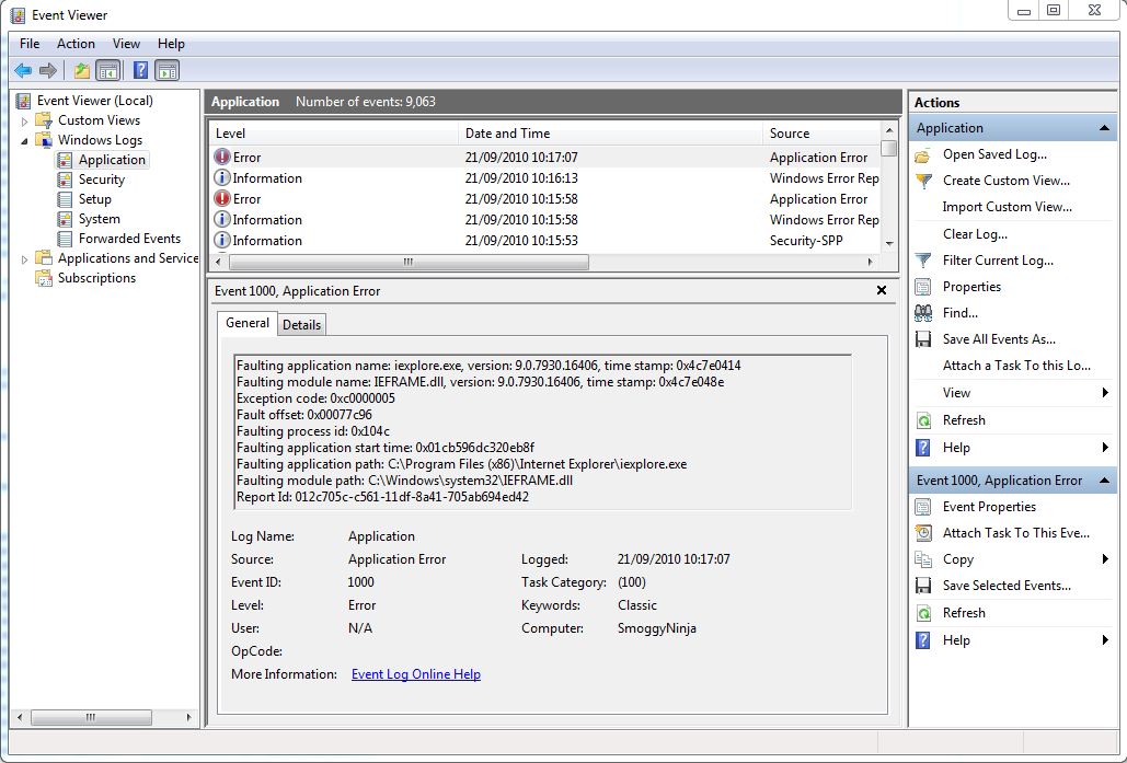

Note: You may also see Event ID 1000 in Event Viewer > Windows Logs > Application log each time IE9 crashes.
Faulting application name: iexplore.exe, version: 9.0.7930.16406, time stamp: 0x4c7e0414
Faulting module name: IEFRAME.dll, version: 9.0.7930.16406, time stamp: 0x4c7e048e
Exception code: 0xc0000005
Fault offset: 0x00077c96
Faulting process id: 0x104c
Faulting application start time: 0x01cb596dc320eb8f
Faulting application path: C:\Program Files (x86)\Internet Explorer\iexplore.exe
Faulting module path: C:\Windows\system32\IEFRAM E.dll
Report Id: 012c705c-c561-11df-8a41-70 5ab694ed42
