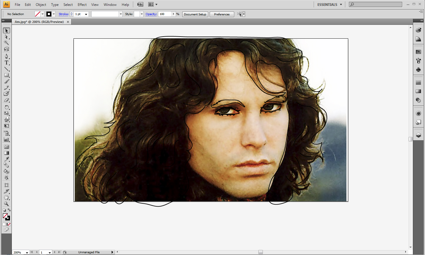

3. Begin Tracing the Profile Picture
Select the pencil tool from the left side toolbar. Begin drawing over the face. It doesn't have to be perfect, just get as close as you can. You can also use the pen tool if you feel more comfortable with it. NOTE: You can adjust the pencil tool setting to your likings by double clicking the pencil tool and changing the Tolerances’. You will see Fidelity, Smoothness both of these control the accuracy of the trace (increase the Smoothness and Fidelity for a more curved and forgiving line). I chose Fidelity 2.5 and Smoothness 3%. For the other options in the pencil tool I left the default settings of Keep Selected, and Edit Selected Paths within 12 pixels (deselect the Keep Selected option if you don't want to hold down the Shift + Ctrl + Alt buttons after each pencil stroke).
4. Trace The Eyes and Eyebrows
I started with the eyes and eyebrows. Try to drag the pencil tool completely around an eye before releasing the tool. You can always type Ctrl + Z to undo the previous trace if you don't like the result. Once you are happy with your traces, hold down Shift + Ctr + A to deselect the shape so you can move on to the next eye, or eyebrow. Continue until you have traced the eyes, eyebrows, and inner eyes. (you can add some small detail on the eyebrows and eyelashes).
