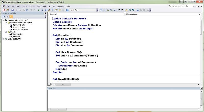

Figure 1 shows the Immediate window.
The Immediate window enables you to test functions and to inquire about and change the values of variables.

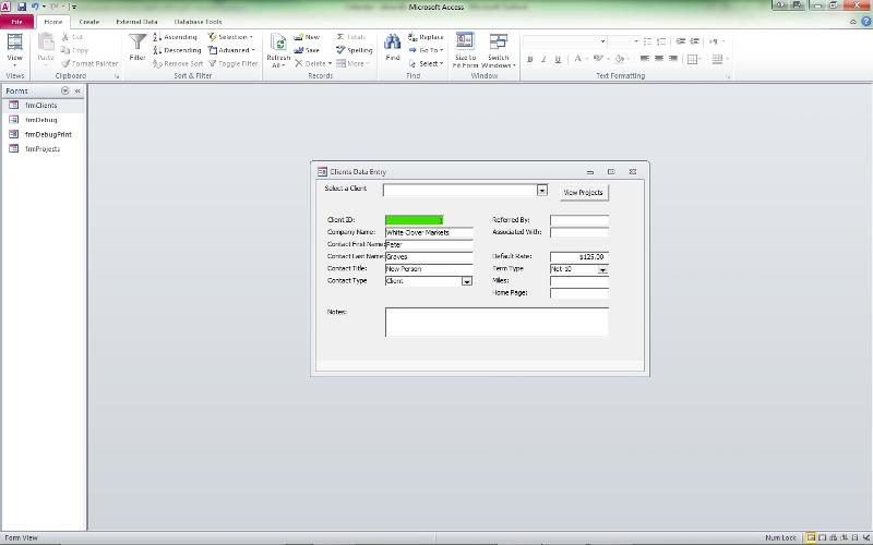

Your screen should look like the one shown in Figure 2. You can continue to request the values of properties or variables within your VBA code.

4.
Type Forms!frmClients.txtClientID.BackColor = 123456. Press Enter. The background color of the txtClientID control on the frmClients form turns green. The Immediate window and your form now look like those shown in Figures 3 and 4, respectively.
The results of using the Immediate window to set the values of properties are shown here.

Printing to the Immediate Window at Runtime
The capability to print to the Immediate window is useful because you can test what is happening as your code executes without having to suspend code execution. It also is valuable to be able to print something to a window when you are testing, without interfering with the user-interface aspect of your code. You can test a form without being interrupted and then go back and view the values of variables and so on. Here’s how the process works:
1.
Type Call LoopThroughCollection in the Immediate window. This calls the user-defined subroutine LoopThroughCollection. The values Skating, Basketball, Hockey, and Skiing appear. The routine prints these values to the Immediate window.

Open the Immediate window. Notice that the routine sent all the statements to the Immediate window (see Figure 5). I coded these Debug.Print statements in all the appropriate form and control events. Note:
