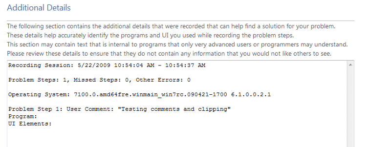

The general usage info is kept at the top of the page to aid the helpdesk in navigating the document. Problem steps shown next allow the help desk to see what the user was doing when the error occurred. This can be viewed as a screen shot right within the HTML file. Lastly the additional details section outlines the OS version and build, and other useful information as well as comments entered by the user.

Figure E Additional info and notes
