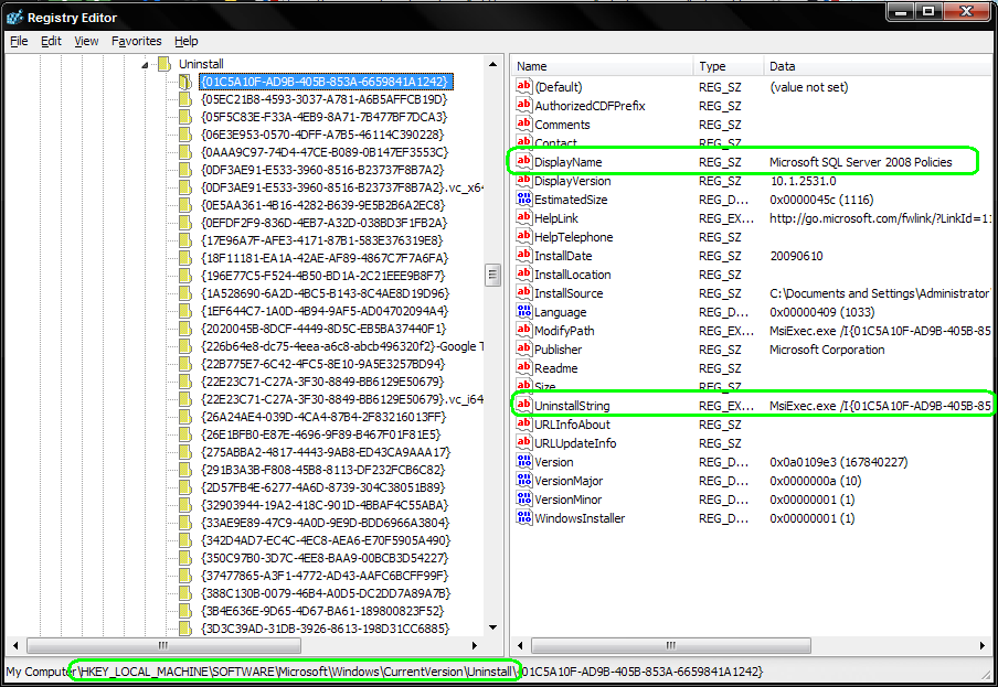

A 'list' of installed programs is in the Registry at: HKLM\Software\Microsoft\Wi ndows\Curr entVersion \Uninstall
(Where HKLM is HKEY_LOCAL_MACHINE). Unfortunately, few of the installed programs reveal themselves as an appropriately named key. You may need to use the Registry Editor's 'Find' feature to look for the program. The image below highlights some key fields containing good information to search for.
  Installed program registry information

You can also find by snooping through the Uninstall directory that there are dozens if not hundreds of programs apparently installed that don't appear in the Add / Remove Programs list. This is either because they are updates (only visible if you click 'show updates' in Add / Remove Programs), or intentionally hidden, or the programmer messed the entry up by not giving it the proper sub-keys. Whatever the reason, you can usually find all sorts of software that you didn't know you had actually installed, but that are removable if you look at the "UninstallString" key and run the value from the command line. If you're an optimization freak like me and are obsessed with removing everything on your computer that you don't use and isn't critical to the system, this is a good place to go fishing for garbage.
An example of the "UninstallString" key is in the registry entries for installed programs image. You can copy the value, and paste it into Start > Run... or a command prompt window to try and uninstall it 'manually'. Careful though, if you use Run..., it might happen in a flash and close before you see what the status is, if you do it in a command prompt window, then you actually get to see whether the uninstall was successful.
By the way, that uninstall string is how the system knows to uninstall the program. If the program messes up what goes in that string, then the system is at a loss for how to install it and will, at best, offer to remove the entry from the Add / Remove Programs List (and registry). This definitely doesn't mean it's gone, and if you're trying to get rid of a virus or adware masking as a program, there's almost zero point in trusting it's uninstaller, (and in fact they are often made to toss an error so that you can never actually uninstall it).
