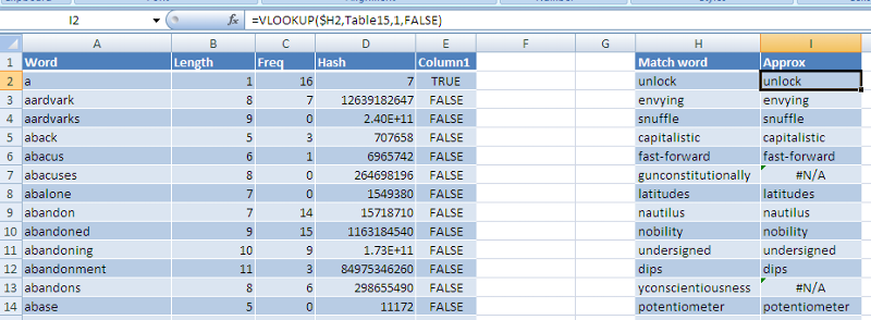

The screenshot shows the standard approach - VLOOKUP with an exact match. I measured the time taken to recalculate Column I, which contains the VLOOKUP formulas, and in this case it was 7.61 seconds.

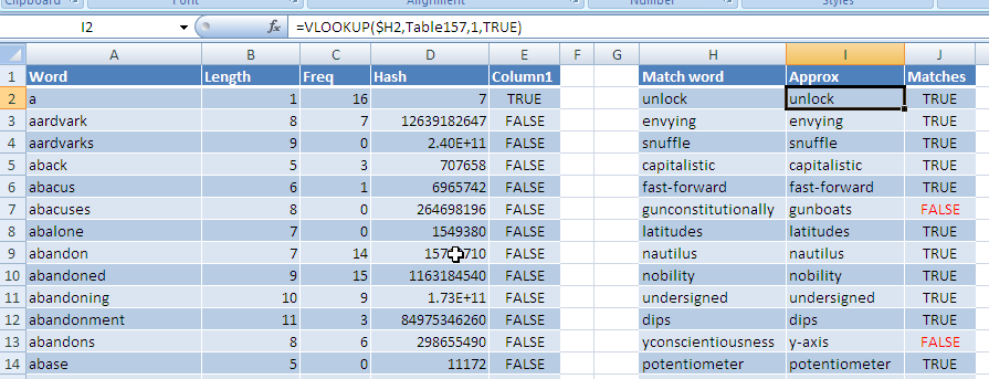

The next screenshot shows the use of approximate matching. You can see that the only difference in the VLOOKUP function is that the last parameter is TRUE rather than FALSE, to request an approximate match in sorted data. Notice where the words did not match in Rows 7 and 13 – the previous word from the dictionary has been returned. The time taken to calculate Column I in this example is 0.024 seconds – 317 times faster! Even including Column J, which checks whether the returned value matches, the total calculation time is only 0.032 seconds.
