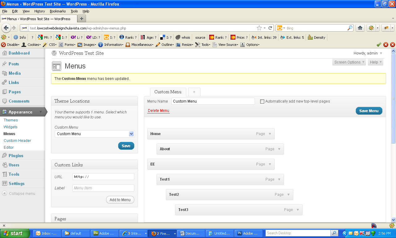

At this point you should have a lot of menu items in the “Custom Menu” box.  Below is a screenshot of mine.  Yours of course will have different menu items:
  After Adding Menu Items
Each of the menu items is drag and drop.  You can easily change the order of the menu items by clicking on the menu item you want to move and dragging it up or down in the menu order.
You can also create submenu items by dragging the menu item to the right or to the left.  A menu item is a submenu item of the menu item it is below and to the right of:
  Adding Submenu Items
In this case I have created two submenus, one sub-submenu, and one sub-sub-submenu.  “About” is a submenu of “Home”, “Test3” is a submenu of “Test2” which in turn is a submenu of “Test1” which itself is a submenu of “EE”.
In order to remove a menu item, you need to click on the down arrow on the right of the menu item and click “Remove”.  You see in the box that opens that you are also able to change the navigation label and the title attribute (the little info box that shows up when you hover over a menu item).
