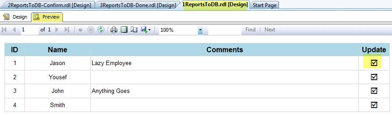

Lets’ run and test it….
 test1
I’ll click next to my name on the check mark to update my comments…

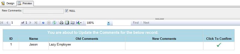

That’s what you get at first because we allowed the NULL, that’s the trick to see the table before the parameter gets initialized.
 test2

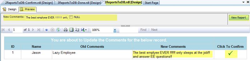

Remove the NULL check mark and enter the new comments….
 test3
You’ll get the confirmation above…
Now click on the check mark to confirm the change,  yes you guessed it right…it’s the wingdings shapes again ¿
And that’s what you get..

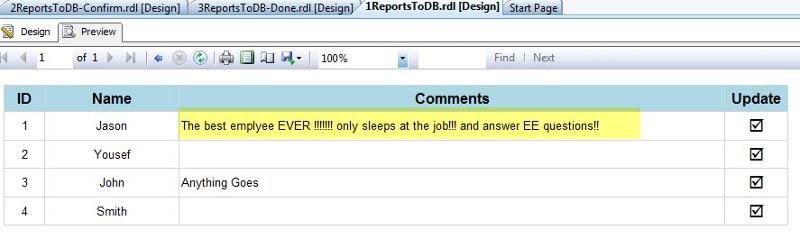

I’ll click on my GO Back, to the first report to check the data.
Done.. my record was updated in the DB.
 test5
