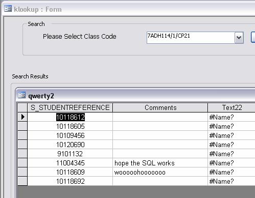

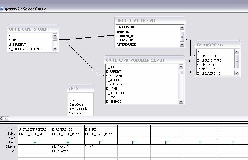

Dlookup problem
Based on the following print screen provided i am trying to do a Dlookup on that query (the tables used are from an external database which i cannot edit). Is it possible to construct a Dlookup based on the following...
I need the student refernce numbers displayed in a text field (set to datasheet view) . They are currently stored in table UNITE_CAPD_STUDENT where the E_REFERENCE stored in table UNITE_CAPD_MODULEENROLMENT needs to be equal to the value being shown in dropdown box on the form (visible in the print screen)
Avatar of deanlee17deanlee17
Ok ive found the Student references in the table UNITE_CAPD_MODULEENROLMENT so i have the following DLookup...
=DLookUp("E_ID","UNITE_CAPD_MODULEENROLMENT","E_REFERENCE=" & [Combo41])
but when it just produces the error '#Name?' am i calling the combo box correctly?

You said ...
>>>>>I need the student refernce numbers displayed in a text field (set to datasheet view) . They are currently stored in table UNITE_CAPD_STUDENT where the E_REFERENCE stored in table UNITE_CAPD_MODULEENROLMENT needs to be equal to the value being shown in dropdown box on the form (visible in the print screen)<<<<<<
After reviewing your Query Grid in the picture you attached ..... Unless I'm totally missing your question here seems like all you have to do is replace the Criteria line for the E_REFERENCE field to the following ....
[Forms]![klookup]![Combo41]
Basically you are saying you want to display the S_STUDENTREFERENCE  field From the UNITE_CAPD_STUDENT table where the E_REFERENCE field in the UNITE_CAPD_MODULEENROLMENT table = the value of Combo41 on the klookup form.  If this correct then the solution above should work.

I got the impression the query was just to illustrate the table structure - it's the '=DLookup(...)' control source expression giving a value of '#Name' that's the problem.
Avatar of Eric ShermanEric Sherman🇺🇸
>>>>I got the impression the query was just to illustrate the table structure - it's the '=DLookup(...)' control source expression giving a value of '#Name' that's the problem.<<<<<<
Originally I got the same impression until I looked at the Criteria line in the Query Grid for the E_REFERENCE field.  He has Like "7*" in there which does not make sense if he is using the value of Combo41 to determine which values are selected.
I think he is trying to get the Select Query to return the values from the table based on Combo41.  Therefore, he really doesn't need a DLookup.

See attachment below. The S_STUDENTREFERNCE field works because the form is bound to the query. But obv i want the form to be bound to risk 2 so as it can save the comments (when i have comments fields) So the DLookup is currently the control source for text22
Oops, didnt attach image
Jez, now all the text22 fields are 12388132
Avatar of Jez WaltersJez Walters🇬🇧
No attachment!
Sorry, looks like we're suffering from comment lag! :-)
So what happend when you tried ID 21230864?
It now has all the text22 fields set to 21230864 :-)

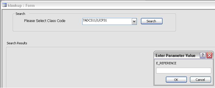

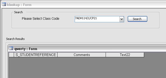

My trouble now is that if change the control source of the form so as its no longer the query but the risk2 tables then i get the following...(see below) I also have the following on event code on the button...

I take it you mean the Record Source for the FORM, not the Control Source of a CONTROL on the form?
Assuming I'm right, you're getting the 'Enter Parameter Value' prompt because E_REFERENCE is not one of the fields in the form's Record Source.
I got [Forms]![klookup]![Combo41] from ID:21230368
Appologies, i meant to say the forms record source. You are correct in what you say, how can i get around this?
My confusion about Combo41 was because you didn't mention that there were two forms until ID 21231215.
As for your E_REFERENCE problem, (apologies if this is obvious) you'll have to add this field to your form's Record Source if you want to reference it!
lol ok but i want the record source to be the risk table so as i can save and retrieve comments from it
What is the Record Source set to when you get the Enter Parameter Value prompt?
Also, what table contains the E_REFERENCE field?
the record source when the prompt appears is Risk2 (the table i have made to keep the comments in) the E_REFERENCE field is stored in the table UNITE_CAPD_STUDENT which is a link table which is joined to the UnitE database
Then you'll have to change the Record Source to be a query that JOINs the 'Risk2' to 'UNITE_CAPD_STUDENT'.

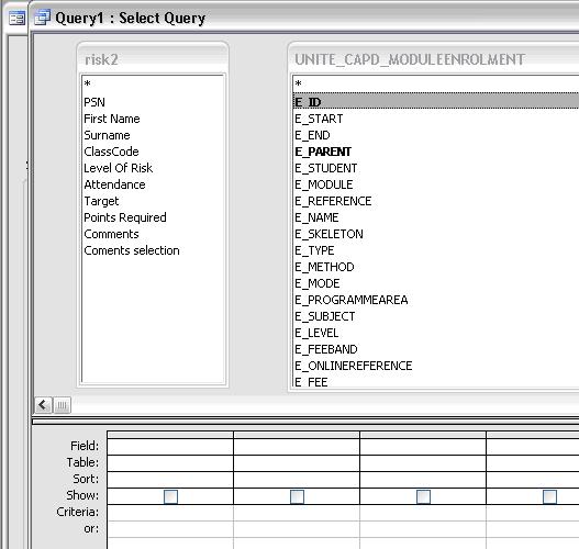

Hmmm ok. Appologies, E_REFERENCE comes from the table UNITE_CAPD_MODULEENROLMENT. What would be the best way to join them as they have no similar fields to link...
You can't join tables if there's no common information, unless one of the two tables always has only 1 record - is this what you have?
Actually i can use PSN and link it to E_ID i think
The result is now...

I take it your Record Source is now something like:
    SELECT *
    FROM risk2 JOIN UNITE_CAPD_MODULEENROLMENT
    ON UNITE_CAPD_MODULEENROLMENT.E_ID = risk2.PSN
Bear in mind that your form will then only display data where corresponding records exist in BOTH tables.

Nah ur alright lol. However....Can you see the problem im having with the KLookup (original problem)
No problem ... actually, I was just about to ask what the Record Source for your klookup form should be set to, to make the form work with your sample data?
Well i dont currently have one, the combobox is populated by the query SELECT qwerty2.E_REFERENCE FROM qwerty2;
Then when the user clicks 'search' then the qwerty2 (i know, i know, NAMING! lol) form appears with the student PSN numbers of students enrolled on that course. The qwerty2 table is the one i wanted to link to the risk2 table
Am I right in thinking that your 'qwerty2' query is ONLY used to populate the drop-down values shown by the 'Combo41' combox box on your 'klookup' form?
Presumably this combo box should just be listing unique values, so there's something wrong with the underlying query used as the Control Source?
My apologies, I've just seen that your 'qwerty2' query is used by the 'Combo41' combo box on your 'klookup' form AND as the Record Source for your 'qwerty' form!
Nonetheless, it still seems wrong that your combo box lists repeated values.  Any thoughts?
Sorry if this is going back over old ground, but your 'qwerty2' query does not return an updateable record set either!
Hmmmm, yes you are right in what you say. I was trying to link the table 'risk2' to that query as well so as i could write comments back to that table. On my drop down the values are unique, actually i did notice that when i imported the tables into the database to send to you that there were duplicates in the dropdown
Yeah the query qwerty2 is broken in terms of linking it to the risk2 table because when i linked the table into the query then the qwerty2 form was only returning a PSN if there was a comment next to it in the table.
Do you reckon that the Control Source for 'Combo41' on your 'klookup' form should be along these lines:

It seems to me that the crux of the problem lies with your 'qwerty2' query - it joins records from your 'risk2' table to your various 'UNITE_...' tables but doesn't specify the join criteria to do so.
Do you think you may have the wrong end of the stick as to how joins work?  Would I a quick recap (particularly regarding catersain-product joins) be worthwhile?
In answer to your last post, in regard to joining tables im just self taught so i expect there are errors there and i have never even heard of catersain-product joins im affraid. I agree with you that joining risk2 to ANY unite table is very much a problem
Just as a side question.... Would you suggest ADO's 'Add' function to copy the contents of one complete column from one table to another? (im not going to have repeating data as i will delete the original column).
Thanks.
A Cartesian-product join is what you get when you have multiple COMMA-SEPARATED tables (or queries) in your FROM clause, like this:
    SELECT *
    FROM Table1, Table2
The above example returns EVERY record in Table1 joined to EVERY record in Table2.  The number of records returned is therefore the number of records in Table1 multiplied by the number of records in Table2 - hence the word 'product' in the name.
Using this form of query you specify the join criteria via the WHERE clause, like this:
    SELECT *
    FROM Table1, Table2
    WHERE Table1.CommonID = Table2.CommonID
In this latter case, the WHERE clause effectively determines whether a particular Table1/Table2 record combination corresponds to a pair of related records in the two tables.  This is precisely the information missing from your 'qwerty2' query - so EVERY combination is returned, hence the multiplicity of records you observe.
Bear in mind also that the records returned by a Cartesian-product join are not updateable - which explains why you can't edit the data.

Now all of the links i have made in queries is just by dragging and dropping betwwen the records which im guessing by fefault makes a 1-1 relationship? Im not sure how to change this to 1-many for example.
The qwerty2 Query
You need to forget about the query builder for now and go right back to basics.
Consider ONE record from your 'risk2' table; does it relate to no records, one record or many records in EACH of your 'UNITE_...' tables?  You also need to establish whether EACH relationship is mandatory or optional.
When you've answered these two questions for your 'risk2', repeat the process for the three 'UNITE_...' tables in turn - and post your answers here!

Morning Jez, ok here we go with some answers, i will try to keep them as simple as possible as i could possibly be confusing myself. The trouble is im obv coming into this with limited experience and the unite database is a bit messy to say the least.
'So where should 'Combo41' on your 'klookup' form get the set of course selections from - is this just the distinct 'E_REFERENCE' field values in your 'UNITE_CAPD_MODULEENROLMENT' table?'...
The combo is getting the E_REFERENCE fields from the query qwerty2 as this filters in the A Level students only hence the like AS* and A2* in the criteria.
The 'UNITE_CAPD_MODULEENROLMENT' table in your sample database has 13609 records with Null 'E_REFERENCE' field values, so I guess you want to ignore these?....
Yes im going to have to as there is no way of linking them so i assume its old data.
Your 'UNITE_T_ATTEND_ALL' table contains 5038 records, all of which have related records in your 'UNITE_CAPD_STUDENT' table - which contains 59931 records.
If you don't join to the 'UNIT_T_ATTEND_ALL' table in your 'qwerty2' query you'll return a LOT more records.
Is this REALLY what you want to do?.....
It is a good idea to join this table into the query. I cannot see how the table was created (and the unite 'expert' guy that created it only works mon & tue) but it was created recently and i think it was created for the surpose of this database.
So where should your 'CourseYRClass' query fit in - and what is its purpose?...
When a lecturer selected a class in the dropdown some of the students were appearing multiple times (this unite expert we have hear 2 days a week) said its to do with the way the database works and added that table for me and said it will now only return each student once, it's something to do with tables between tables in unite.
Is that any clearer?
Many Thanks.

Right, let's start from the beginning and go ONE question at a time.  First of all, imagine you have absolutely NO queries in your database WHATSOEVER - just tables.  From this point of view, where does the set of class codes you want to select from get populated from?
Initially answer this question in straight English-language terms ("I get the set of class codes from the ... information") -  this should express your requirements in understandable, REAL-WORLD terms.  Next, translate this into field/table equivalents ("The ... information is determined from the ... field of the ... table, where .. field values also exist in the ... table ...").
I will wait for your answer before proceeding further.
Actually ive just changed the testa query. The relationship from the students table to risk2 is now one to many, i have set recordset type to dynaset with inconsistant updates for the testa query and the qwerty2 form and it ALL works fine!!!!
Essentially i split the query.
