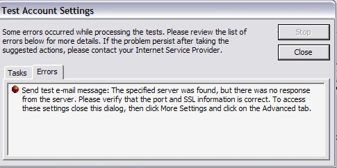

Outlook (2002) has suddenly stopped sending/receiving my e-mails. It was fine before the weekend and I have not altered anything. A system restore back to when it was OK, and a reinstallation of MS Office have not helped.
I am pretty much 100% sure my account settings in Outlook are fine (there are two - both for yahoo.com): they are the same as those I have always used. My e-mail, pop3 & smtp addresses are correct, as are my port settings (verified with yahoo). I have tried with and without SSL (changing ports as required), and the authentification box needed for Yahoo mail is checked. I tried both .com and .co.uk for the mail servers.
I also checked that I have all the shell folders in place in the registry (windows/current version) - and am now at a loss. I can't get Outlook Express to work either..
Contacted my ISP (BT) who spent an hour with me, with remote access to my PC, but they could find nothing wrong with the settings, so that was a waste of time.
I will attach screen shots showing settings and error messages when I try 'Test Account Settings', with and without SSL. If I try to send a real message within Outlook I am either told that it cannot connect to the server or that the server was found but there was nor response. And I get the dreaded @Enter Network Password' box up every 10 seconds..
All very depressing! Hope someone can help...

According to the message in the last image. Verify the email-address field. Typo there maybe?

Yahoo's SMTP server requires authentication.    "My server requires Authentication".  Verify that setting from the account's properties.
Also try port 587 for outgoing when using the SSL setup.  You will want to use SSL to protect your account credentials.

Thereare no typos or other obvious mistakes - 100% sure. Boxes for authentification are all as they should be (and always have been when Outlook worked fine).
Tried telnet mail.yahoo.com + port number. I get 'Connecting to mail.yahoo.com...' and I can see there is internet activity from the icon in the system tray. After about 20" the box just closes. Same with all port numbers I try.
Same also if I shut down my firewall completely. Net result - Outlook keeps telling me to verify the e-mail address: which of course I have done a hundred times now (and the password)..
Sigh ...

And you have tried that alternative port, tcp/587 (submission) with no success?
How about SSL / TLS settings?
martinlest
With no SSL, ports are 110 & 25. Tried 465 and 587 instead of 25. With SSL, ports are 995 and 25. Tried 465 and 587 also instead of 25. None of those work. I can't see any other variables in Outlook account settings that I can change..
Test Account Settings says it has found POP3 and smtp servers, but then the email test sending fails: just a note to verify my email address.
