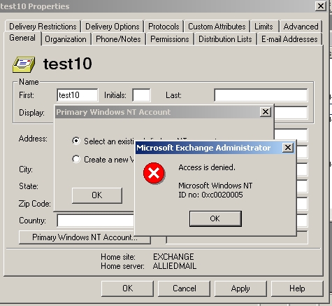

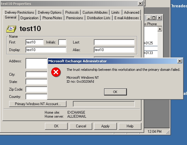

dmb2002man
I have manually added both the same ip, gateway, dns, wins, etc as the real environment so everything should be okay with that.   Now i have created a new account on the domain controller called test10 and then when i go over to the exchange server 5.5 and i try to add a new acccount called test10 then i click add the primary windows NT account, i get access denied.
Also get this error when trying to delete an account in exchange administrator.
The trust relationship between this workstation and the primary domain fialed.  Microsoft Windows NT.
ID NO:  0xc00206fd
Here i am posted screenshots of what im talking about.

Erik Bjers
http://support.microsoft.com/kb/q162797
Will tell you why and it says you need to remove the computer from the domain and add it again.

I figured it out already by resync the time and rebooting each of the servers at the same time and then they each booted up with error message.  So on the domain i added a new account called test10 and then on the exchange server i created a new email address called test10 and the primary nt account i connected with test10 and that works.   Now i have added another test machine to the switch with windows xp and outlook on it and readded it to the domain and that worked but it was also getting a syncing issue so i ran the command w32tm /config /update and w32tm /resync.  I am now rebooting the machine and seeing if that will work.  We are moving along iwth this project and i appreciate it all yoru help with it so far.  Thanks so so much.
