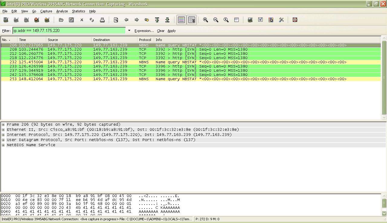

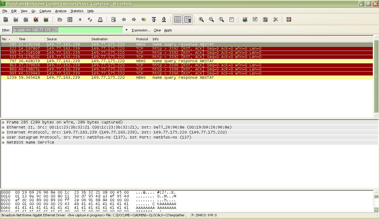

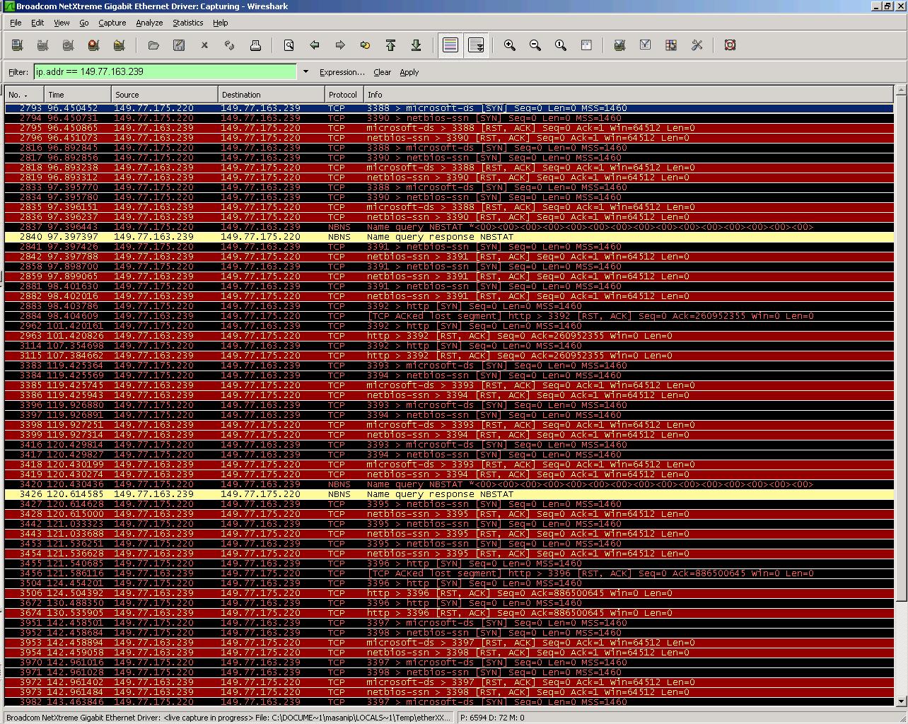

I did following tests and got the packets information using wireshark.
If I disable wireless interface then there is no use and behavior will be same. Now I have disabled wired interface as below:

Now only wireless interface is there on destination machine. Now from source machine(149.77.175.220), if I tried to do \\149.77.163.239\C$ then also I am getting "Network path not found"(Please refer the attached snapshots of both the machines packets trace).But still \\149.77.172.132\C$ works fine. This will work because through wired interface communication router will not come into the picture as both the machines(while looking as wired interface) are in same network so they can communicate via access switch itself.
Aha...I got the exact problem now. Please see below:
When I try to do \\149.77.163.239\C$(wireless IP - this is destination machine) from 149.77.175.220(wired IP - this is Source machine) the request goes via local router to 149.77.163.239 because source machine will understand that wireless IP 149.77.163.239  is not in my network. When destination 149.77.163.239 machine got the request from 149.77.175.220, it will understand that this machine is in my network(because of wired 149.77.172.132 IP) and it will reply via access switch. Ahaa I think now I am right. What I want even though destination machine understand that 149.77.175.220 is in my network, it should sent a reply packet via the interface from where packets arrived. If this is done then there will not be any problem.
Could you suggest to make this possible so that destination machine should reply from the interface from where request packate arrieved.

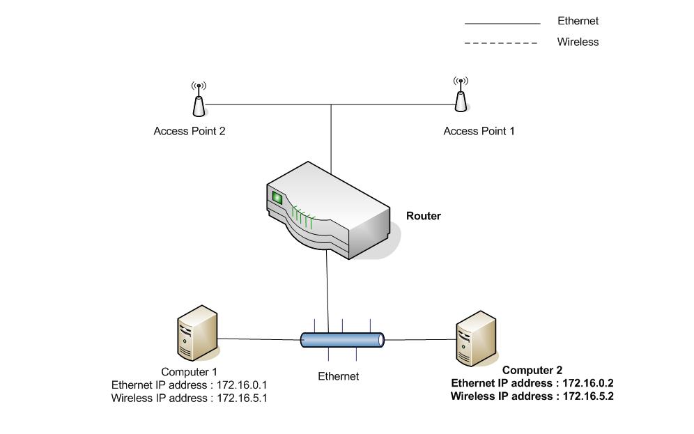

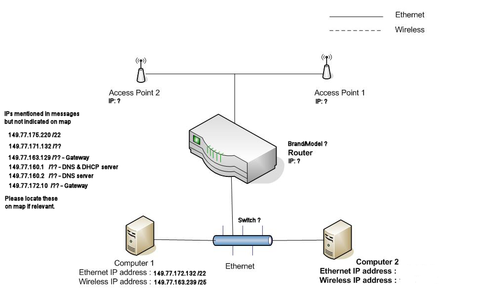

Could you show us a lightweight/limited 'map' of the layout (do youhave Visio, or the OpenOffice Draw program?), or a more-complete description of exactly what you're trying to do, please?
I think you've just about talked yourself through it, but I'd like to make sure we understand too. ;-)

Sorry forgot to attached Traces file...I have also attached visio diagram of our networkd. The IP addresses given is not a true but just for an example.

>>Could you show us a lightweight/limited 'map' of the layout (do youhave Visio, or the OpenOffice >>Draw program?), or a more-complete description of exactly what you're trying to do, please?
You can see network.jpg in previous reply for our network architecture and I think following paragraphs tells in detailed what i trying to do. Please let me know if you are looking for any specific details.

I think this problem is nothing to do with an our network architecture but its related to packate forwarding rules.** If machine replies on the interface from where packate arrieves then there will not be any problem.** Could any one please let me know if this is happening in Microsoft TCP stack?
Here it is giving priority over local lan over wireless and the problem is arised.

I'm still trying to get a clear picture of the layout in my mind. Attached, I've modified your map as much as I could to match what you've told us so far. Could you modify it further to show us what you have, please?
Only one more comment.
Why do you want to have a dual connectivity that interfere one with the other ?
Microsoft networking takes some decision based on connection speed and reliability of link.
It normally defaults to wired connectivity so you always have troubles tryng to use two links togheter.
Leave only one link enabled, wired or wireless, not important, and troubles goes away.
