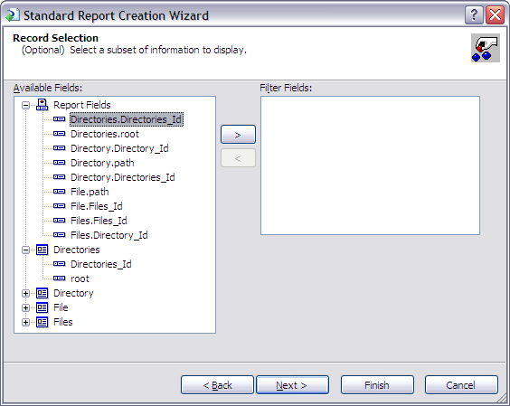

If you went through the report designer, you would see the Filter Fields, which you can use to filter the data.

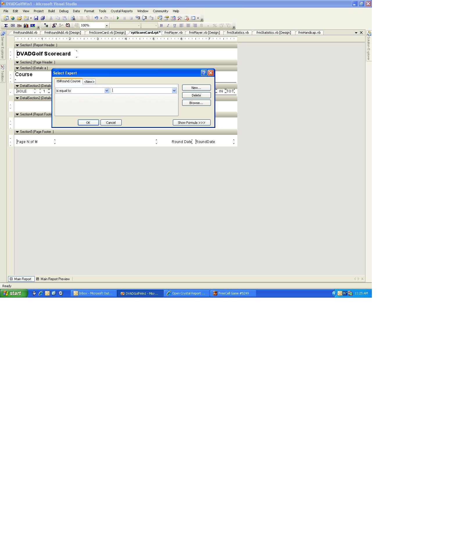

I was going at it from the select expert. Choosing my field equal to .... but there is no option for a form field. I just get an option to do it like this
{tblRound.Course} = "Thomas Carvel Country Club"
That works to only show that record but I may not always want that record.

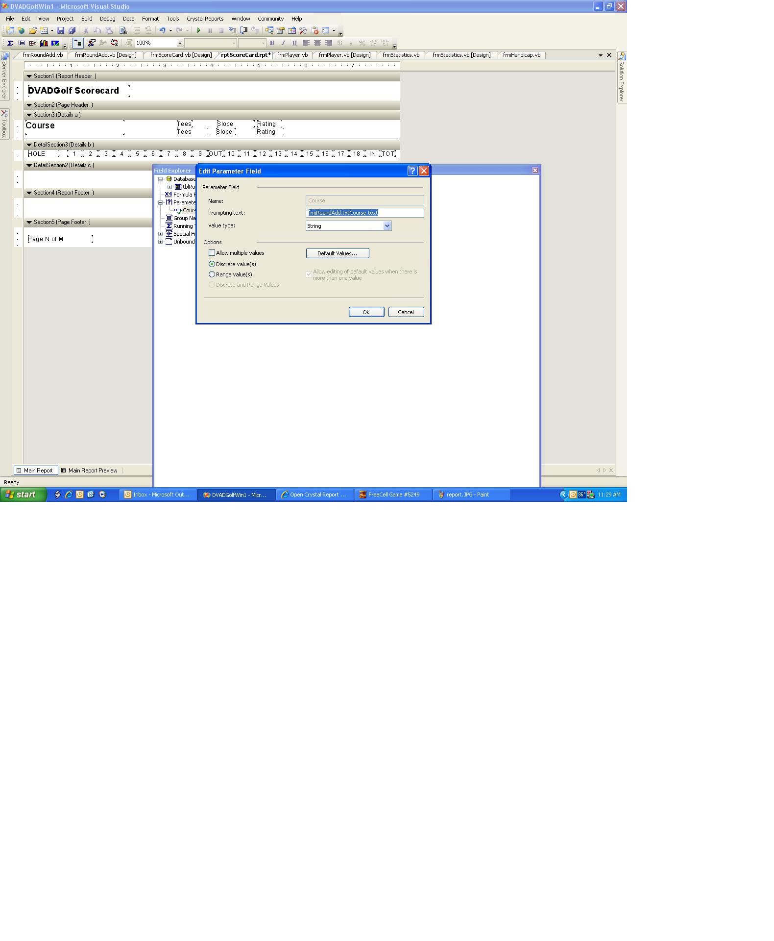

Add a parameter to the Crystal Report, and then pass in the TextBox.Text to the parameter, and use that for the filter criteria.
Avatar of wiswalld
wiswalld
That was were I got started. I thought that was the way to go but I wasn't sure what to put for Prompting Text or how to pass the parameter.

Or for the parameter

I have simply designed the report and I open with a button. Shows how dumb I am I am not exactly sure what you mean. I think you mean do I use code to open the report. Then no. The wizard created all connections for me and populates the fields I added to the report. I have since created a parameter and added to the report. I have then set the Course name to equal that parameter. But I am prompted for a discrete value when opening the report. The report will populate fine if I enter a value.
