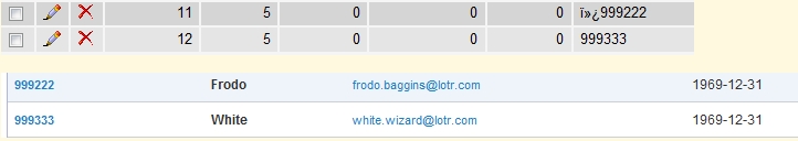

Avatar of ssjo22
ssjo22
Flag of Canada image
Three things:
1. After import, the first username imported has these strange characters in front of it. The 2nd imported seems ok. See attached image username-and-date-wrong.jpg.
2. The date function now() doesn't seem to work, as it has set the date to be 1969-12-31. Also see attached image username-and-date-wrong.jpg.
3. I need - a uniqueNumber - a random 32 character string, used for session cookies. I believe it also has to be hashed.  I tried adding this:

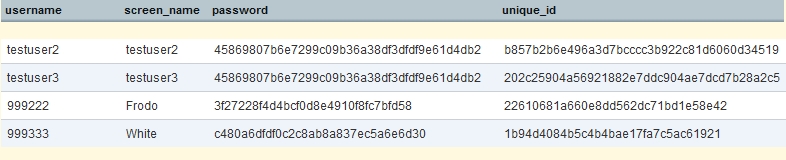

Avatar of ssjo22
ssjo22
Oops, didn't finish the above entry... actually 4 things:
3. I need - a uniqueNumber - a random 32 character string, used for session cookies. I believe it also has to be hashed.  I tried using this function to generate a unique ID.
But hash doesn't work on my test server -- I must be using PHP4. (The live server is using PHP5.) So instead of hash, i use md5 there. Please see attached image problem-md5.jpg.
Testuser2 and Testuser3 are NOT imported using the script. They are created in the system and their passwords and unique_id hashes are 40 characters long.
When using import script, the unique ID's created for Frodo and Wizard are only 32 characters long.
4.  The fourth issue: notice the passwords. They are also only 32 characters long when imported using the script. The system generates 40 character long ones for testuser2 and testuser3.
Your help is very much appreciated. Thank you!

Avatar of ssjo22
ssjo22
Thanks Roonaan!
#1. - Yes, the CSV file was UTF, changed it and now it imports without the funny characters at the beginning.
#2 and #3 - uniqueID seems to be working. Both uniqueID and password needed to be sha1, that was my mistake. But now they are OK.
#4 - now() is NOT working on the live server either. I looked at the table in phpmyAdmin and it says the date should be int(10) unsigned. When importing with now() function, it only shows the year 2008 when I look at it in phpmyadmin.
So, other than the date, that's it --- we're really close now. Almost...
Thanks again for your help.
Avatar of ssjo22
ssjo22
ok, found it, it is using unix time stamp, I think 1216199294.
