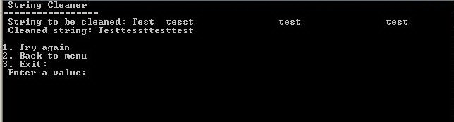

void cleanText()
start:
	system("cls");
	char s[Size];
	string text;
	cout<<"String to be cleaned: ";
	fflush(stdin);
	cin.getline(s, Size);
	text = s;
    for (int i = 0; i < strlen(s); i++)// entire string
		if (isspace(text[i]))
			if((i = text.find(' ')) != string::npos)
                                  text.erase(i, 1);
			if((i = text.find('\t')) != string::npos)
				text.erase(i,1);
				text.insert(i,1, ' ');
	cout<<" Cleaned string: "<<text<<endl<<endl;

>> but at presnet my code is not work with isspace()
That has nothing to do with isspace ;) Your current code simply erases all spaces. You should keep one, and erase all the others that immediately follow it.
