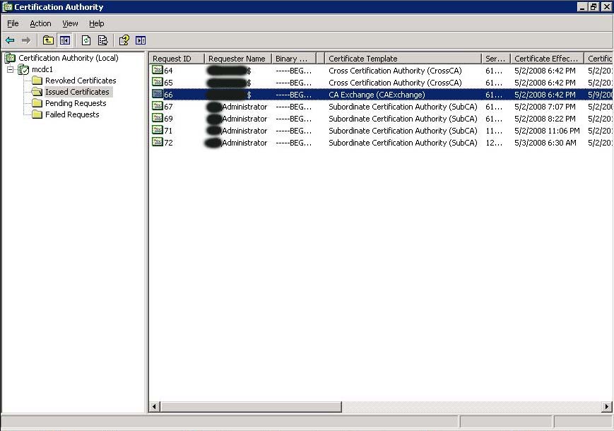

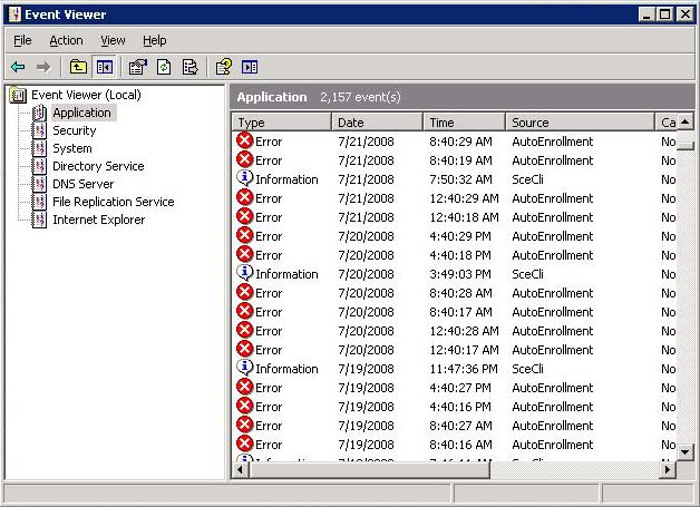

Here is some screenshots of what I see happening if that helps at all.
The first is the Event Viewer that shows the error. It happens every 8 hours but it shows twice about 10 seconds apart.
The second is the actual error.
The third is the CA snap-in. I don't know what the "CA Exchange (CAExchange)" certificate is or what it does but it's expired. As far as functionality goes everything works fine from logging into the domain to Exchange working. Also OWA works fine but it's 3rd party certificate. This might have nothing to do with anything but I just wanted to point it out also.
The fourth screenshot shows the expired certifcate which is the dc1-xchg.

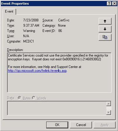

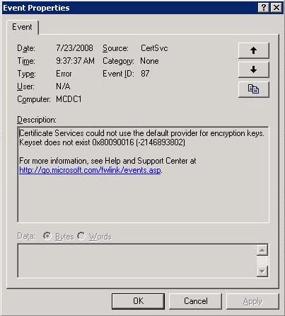

Darius something new that I have been missing. I started going through the entire event viewer logs and under "DNS Server" on the DC with the issues I get this error every time I reboot. It's never shows up any other time except on a reboot ONLY.

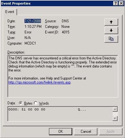

Some interesting things happened while going through that article. Two new errors popped up in the Event Viewer and the CA Exchange certificate renewed itself. I did a reboot after but the same autoenrollment error is still there.
I also got an error when running the "certutil -cainfo" command. I don't know if they are critical but they were "Error: No CRL for this Cert". They are listed below. I also attached the screenshots of the Event Viewer Errors.

Yeah I tried reinstalling the CA and then restoring. I followed this article when I migrated. http://support.microsoft.com/kb/298138 I also restored it again earlier today.
Yes I had to physical boxes and I virtualized DC1 and left DC2 on it's original standalone server.
Here is a screenshot of where the Recovery Tab should be but it's the same on the both boxes. I am sorry I don't know how to query the domain to view the CA in AD. I did go through all the links and steps that you have sent me so for if one of them was it. If I did find an error I tried to post it for you.
I looked through that article and our group policy is setup and has been running four about 4 years so I believe it's correct but I read through it and also checked the settings in group policy.
I see our Exchange server is getting the same exact error now but it seems to be running fine so far.
Here is a screenshot of the tabs I have. Do you think calling Microsoft is going to be the fix? I have read so many articles that my head is swimming in information! :) This has to be one of the more elusive problems I have ran into.
