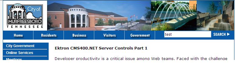

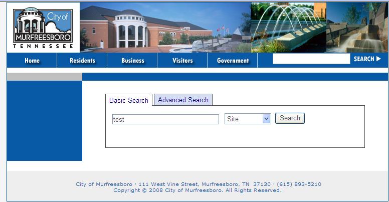

Hello.  This one is going to be a tough one, because I really don't know what I'm talking about.  I am trying to get a search to work(an internal website search), and  I'm getting an error in firebug that says "unterminated string literal".  Here's the code that it's flagging:

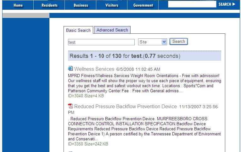

Avatar of thedeal56
thedeal56
I can't seem to find where those table header tags are being generated.  I added the backslash, and it now says "missing ; before statement".  I thought I might should post the entire section code that the error is found in.  You can see the actual results of the search showing up in script, but they will not display on the site.  Thanks again for all your help.

and that produced no error.  It also produced no results, so I searched around for WebSearch1.  I found it in
this:
I then switched the ShowSearchBoxAlways value to true, and I was able to see my results.  The only problem now is that I can't search from my search box on my masterpage.  Well, I can search from it, but the result display is not automatic.  I'm posting some pictures so I can better explain it.
In the Master Page picture, that is were the initial search will entered.  The Search Page is where the search variable will taken in order to display the results.  The problem is on this page, because the variable is being passed to the page, but it's not searching automatically.  The user will have to click the other search button in order to display the results that are shown in the Results picture.  Is there a way to bypass that other submit button?
I suppose concatenating WebSearch1.Text to the innerHTML is the piece of code that wire your search output to be displayed automatically on the Search Page?
