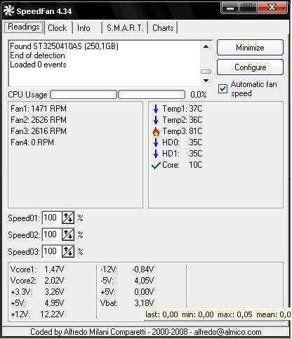

Hi! I received this result in Speedfan and I am a bit confused of these 81C which I see! Can you tell me what might be the problem? I will appreciate if you give me some link to "help" section or "how to use" manual of Speedfan cause I have no Idea of the temps shown there to which component they respond! Thank you!!

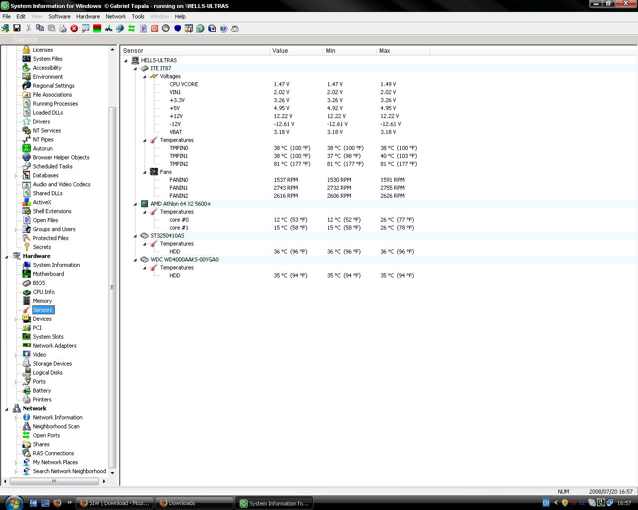

Use SIW to check temps and determine which is which.
http://www.gtopala.com/
I suspect high temp is GPU (video card).

it is impossible to be video card as under full load VGA is 65-67C because under it is Zalman VF1000 and all the rams are with heat sinks and over it on the back of the chip is 40mm blue Ice with cooler and fan! idel temp of vga is 39-42C

if you talk about this screen I still dont understand what is si high in my system! :( Still need help!!
Avatar of willcomp
willcomp
That is a motherboard sensor. Possibly northbridge chip. Cannot tell for certain.

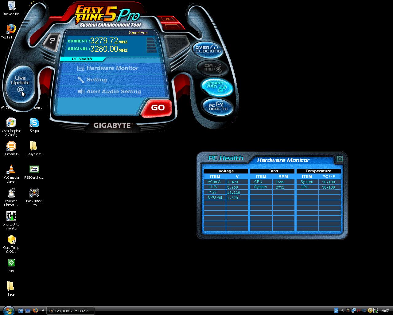

I am with Gigabyte , and didnt find any temp  monitor in the site , I read only somewhere that easy tune could be used for it! I installed Hwmonitor and it ran normally only once and showed also 81C , on next reboot it only showed me the hdd temps, without any MB C . I am not in forn of my PC now , I am working but  I am conected on remote , so I cant see the temp at the moment but Last night I dont remember to have seen such high temp. Mainly my case is blowing in with one 80mm and one 120mm fans and separately has a hole with filter where the floppy should be, I clean the dust 1 time per month and on the backpanel I have more 1 120mm and 1 92mm fans blowing out. Cpu cooler at this moment is Akasa 876 through the rest time I am with Xigmatek 1283HDT.
Avatar of sirdoneff
sirdoneff
Flag of Bulgaria image
here it is from Easy Tune 5  hardware monitor:

I think it is the last one because when I go to advanced settings in speedfan and toggle thermistor to diode the temp becomes -72C !!! So I will try  to search for a hot place in my mobo , bu think it will be enough to turn off the monitor from this sensor. On my work PC I installed SIW and it shows me 25C , so it is nothing I can feel.

new moment , when I turn 3d view in Ati Tool to see the temps, this sensor increases to 82-83 but not more! so it is not dead end but might be wrong reading!!any suggestion , from where I can get info which this sensor is???

Easy Tune (which is Gigabyte's)Shows me only CPU and system and they are both well low!
