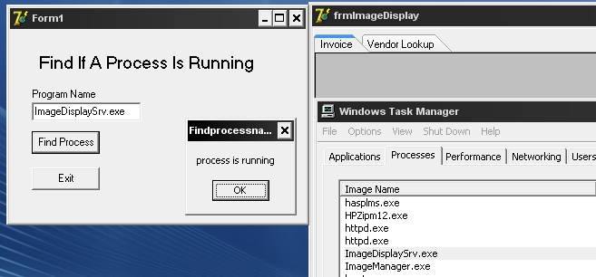

There are programs on the internet which if you enter a program name, it will return the handle to that program, provided it is running.   See picture below as an example.
