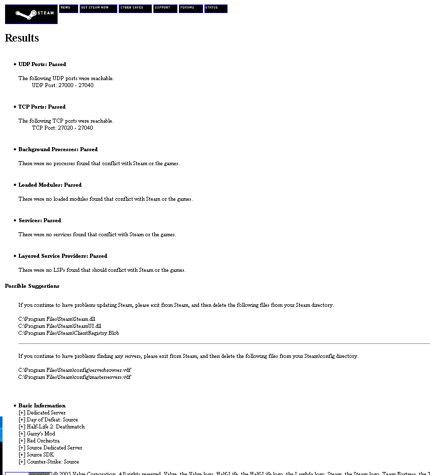

How do i set my steam games to send my WAN IP instead of my LAN IP?
I have recently been trying to setup a few servers on steam for my freinds to play on, but when they click on Join Game, it tries to send them to my LAN IP (192.168.1.20) instead on my WAN IP. I know I have all of the ports forwarded correctly, because if they type connect (WAN IP):27015 into the console they can connect and play. (I have attached my steam connection test results to the question).
