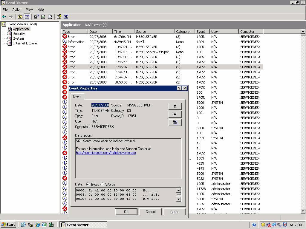

Hello,

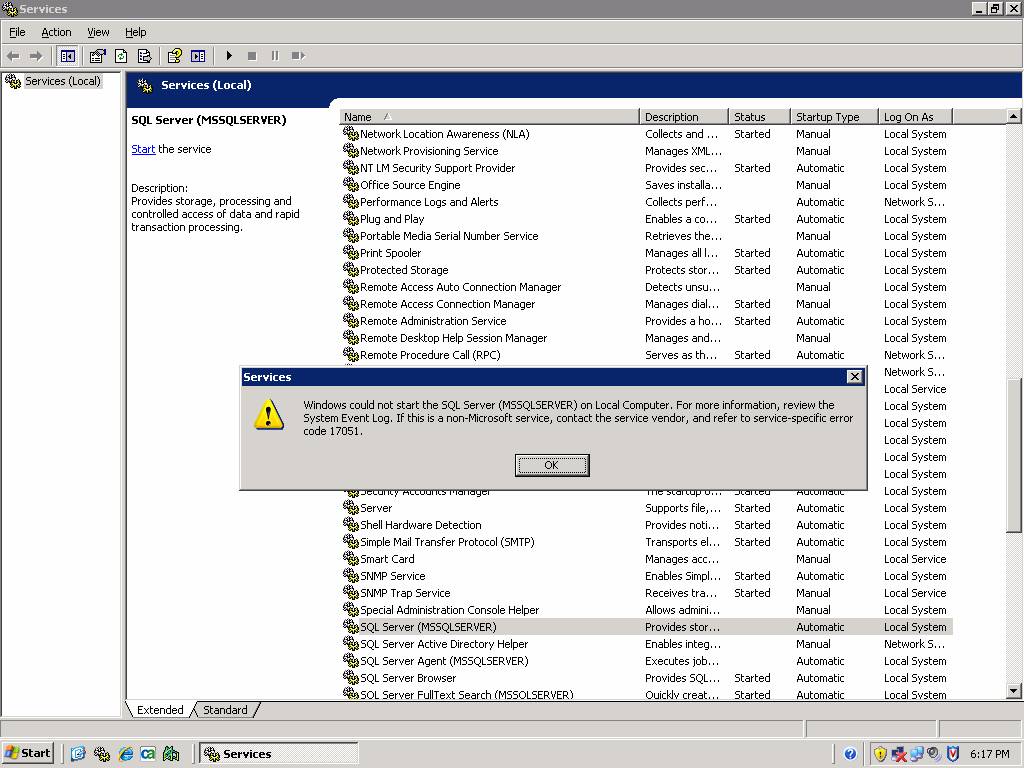

I installed SQL Server 2005 Enterprise Evaluation edition on my server, now I got following error...Evaluation period has expired. As a result, my program using SQL Enterprise Evaluation can no longer start! (CA Unicenter Service Desk).
