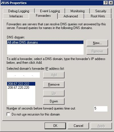

Yes, at the office I'm at now I use OpenDNS as the forwarding servers in the Active Directory DNS server on site.  All of the client machines connect to this local DNS server (as all good AD machines do) and ask it for the lookup information.  It then asks OpenDNS for the right answer (as opposed to my ISPs DNS).
I use Server 2003 Standard and not SBS, but the setup should be very close.  From the DNS control applet, right click on the server and select properties.  Select the "Forwarders" tab in the window that appears.  In the top box, you should have "All other DNS domains" highlighted.  In the lower box (the one for IP addresses) make sure that the 2 OpenDNS IPs are listed (208.67.222.222 & 208.67.220.220)  You can see this in the picture i'm attaching.

in that same window i pictured above, you would click "New..." next to the "DNS domain:" box and enter the domain that you want a custom forwarder for (in this case "ralls-group.com").  Then when it is highlighted in the top (DNS domain) window, put the IPs of its DNS server(s) in the lower IP window.
What that will do is say "If the request is for anything at *.ralls-group.com then go to the DNS at these IPs.  For all other DNS domains, go to the OpenDNS servers at these 2 IPs"
While I edited it out of the picture above (for security and confidentiality and all) there are actually 3 other forwarding domains setup on that server ;-)

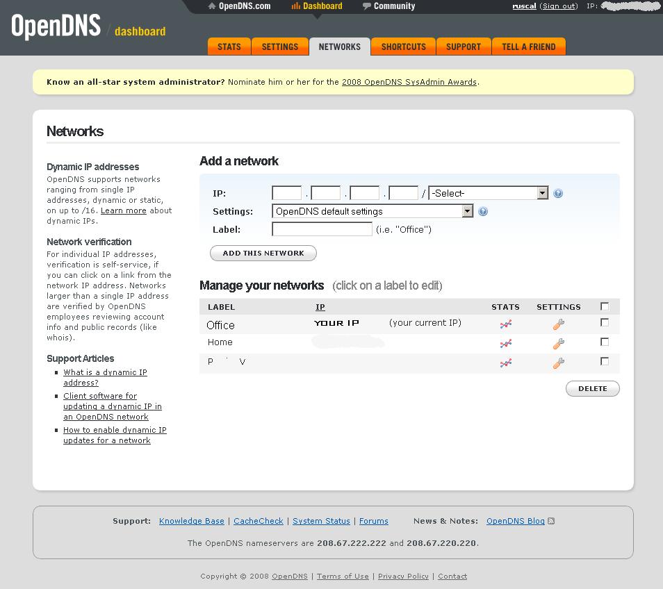

Also, when you sign into opendns, in the dashboard under networks, does it say (your current ip) next to the ip of your network.  (see attached pic for an example of where i'm looking) you may need to actually browse to ipchicken or opendns from the server itself to see the correct ip listed.
and finally, how much time did you give it.  when you create a new network it tells you how long it will take for those settings to replicate to all of their servers (something like 15-30 min) before your settings first start working.  but trust me, when they kick in and  it blocks myspace, you'll know. ;-)

my post above, with the screen cap of the opendns dashboard... when you browse to the dashboard from the server, do you see "(your current ip)" by the network you created for the office?
Avatar of paulmcguire7002
yep and in the settings it has **.**.**.66/32

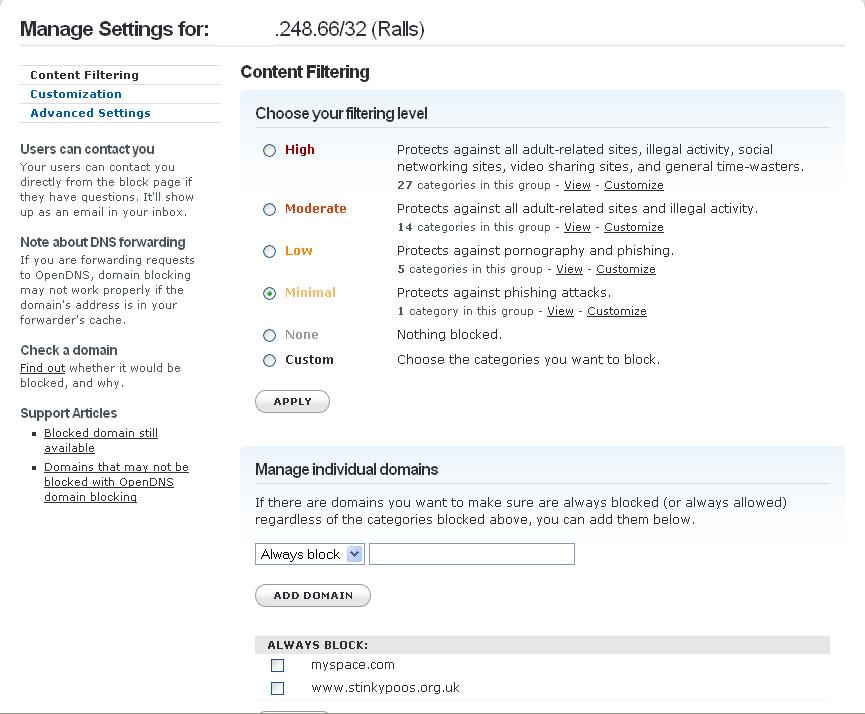

Ahh, the minimal filter setting only blocks domains that are known as phishing sites.  You should up (or customize) your filtering level to actually get positive blocking.  The site I'm at right now actually uses the High setting without disrupting normal work activities.  The biggest advantage here has been that they run a call center and a few of the operators were going along at about 40% of what everyone else was doing, found out they were spending all day on facebook.  Killed that pretty quick when we turned this on.
But yeah, the minimal filtering level hardly blocks anything.  Once you up the filtering level give it a few minutes (about 5) and flush your DNS's cache and your local DNS cache again, then try a forbidden site.
Oops, scratch most of that, I see the always block list now... hurm.... perhaps try clearing the cache(s) again then attempting to get to MySpace
