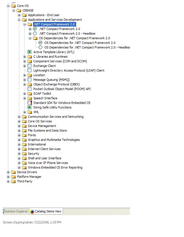

are you sure you added the Compact Framework Version and not the Desktop Framework?
Avatar of AndrewJen
AndrewJen
I believe so, I've attached a screen clipping of the O/S image I'm using, which includes the Compact Framework 2.0.

I solved this problem by manually installing the Compact Framework on a standalone PC and then copying the relevant DLL files to my device.
Avatar of AndrewJen
AndrewJen
Thanks to all for assistance - selecting the Compact Framework in the Platformbuilder didn't supply all of the essential files. Your answers helped me search in the correct direction.
