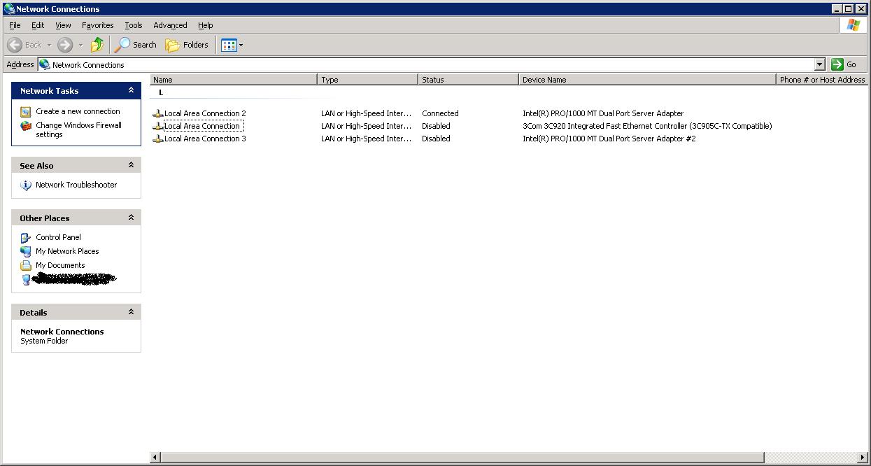

Attached is a print screen.

I'm not certain, but I believe the Connection #2 is the virtualized driver ... and it's already using the two physical cards shown below (as "disabled" -- because they aren't directly used).
If that's not right, I'm not sure what you need, as Intel's site does not have a separate download for this card ... they simply note what I indicated above => that the Advanced Networking Services software handles the load balancing automatically.
A simple test:  physically disconnect one of the ethernet cables and confirm everything still works :-)

I had to disable one of the ports because it's on my mail server and when both were enabled the mail connection went down, I suppose there was confusion with DNS. Connection 2 is the first (configured) port on the duel port card, connection 3 is the other port on that card. The other LAN connection is the original on-board card.
