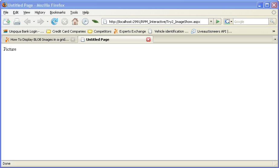

No red cross. Blank screen. (Actually ... if I use the "alt", I see the text of the "alt").  I'm not sure what you mean by authentication.

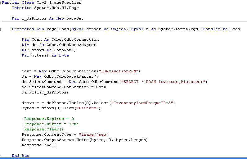

Here is the Image_supplier code as it stands now.
Partial Class Try2_ImageSupplier
    Inherits System.Web.UI.Page
    Dim m_dsPhotos As New DataSet
    Protected Sub Page_Load(ByVal sender As Object, ByVal e As System.EventArgs) Handles Me.Load
        Dim Conn As Odbc.OdbcConnection
        Dim da As Odbc.OdbcDataAdapter
        Dim drows As DataRow()
        Dim bytes() As Byte
        Conn = New Odbc.OdbcConnection("DSN=AuctionRPM")
        da = New Odbc.OdbcDataAdapter()
        da.SelectCommand = New Odbc.OdbcCommand("SELECT * FROM InventoryPictures;")
        da.SelectCommand.Connection = Conn
        da.Fill(m_dsPhotos)
        drows = m_dsPhotos.Tables(0).Select("InventoryItemUniqueID=3")
        bytes = drows(0).Item("Picture")
        'Response.Expires = 0
        'Response.Buffer = True
        'Response.Clear()
        Response.ContentType = "image/jpeg"
        Response.OutputStream.Write(bytes, 0, bytes.Length)
        Response.End()
    End Sub
End Class

Avatar of dzumwalt
dzumwalt
Here are three images. One is the browser, and the other two are the code pages.
Again ... thanks!

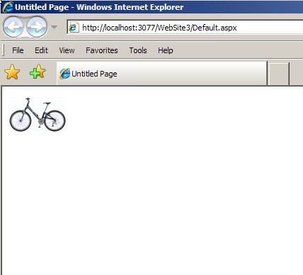

The code runs ok on my machine. Here is my code and a screen shot (I am using AdventureWorks2000 database). Make sure there is data in your dataset and the selected datarow.
<%@ Page Language="VB" AutoEventWireup="false" CodeFile="Default.aspx.vb" Inherits="_Default" %>
<html xmlns="http://www.w3.org/1999/xhtml" >
<head runat="server">
    <title>Untitled Page</title>
</head>
<body>
    <div>
        <asp:Image ID="imgPicture" runat="server" AlternateText="Picture" ImageUrl="~/Draw.aspx" /></div>
    </form>
</body>
</html>
'Draw.aspx
Partial Class Draw
    Dim ds As New DataSet
        Dim conn As New SqlConnection(ConfigurationManager.ConnectionStrings("AdventureWorks2000ConnectionString").ToString())
        Dim sda As New SqlDataAdapter()
        sda.SelectCommand = New SqlCommand("SELECT ThumbNailPhoto, LargePhoto FROM ProductPhoto WHERE (ProductPhotoID = 1)", conn)
        sda.Fill(ds)
        Dim dr As DataRow = ds.Tables(0).Rows(0)
        Dim data() As Byte
        data = dr("ThumbNailPhoto")
        Response.OutputStream.Write(data, 0, data.Length)
        Response.End()
    End Sub
End Class

OK. Figured out how to set the defautl browser for the file. (right click on the file and choose "browse with").
Now that I am using IE, I am now getting an red X.

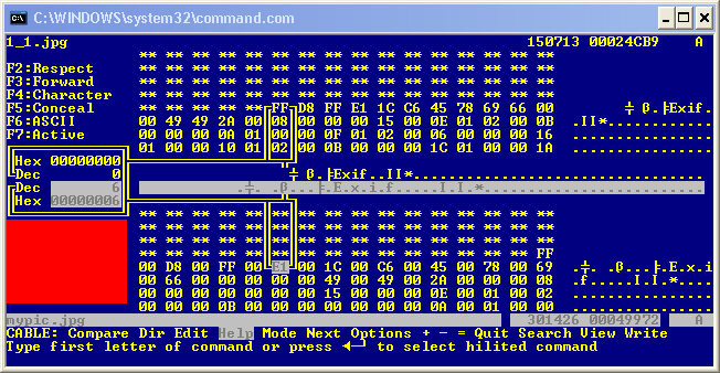

OK. I think we are real close now.
The image was originally placed in the database by a VB6 application. In that application I am using ADO to read/write the picture data to/from the database.
I notice that rst.Fields("Picture").ActualSize in the vb6 application reports the size of the jpg as 301426 however in that application I am writing the database field to a string variable. When I do, the resultant length of that string is exactly half (150713). Performing a binary write of that string to a disk file creates a good jpg file.
In an effort to prove the third item in your last post, in the asp.net code I took the contents of the database picture field and wrote it to a file. That file turned out to be 301426 bytes in size.  Doing a byte by byte comparison of the original file and this one that I wrote out, I notice that there is a ton of nulls (seems like every other character) in the 301426 sized file.
I guess if I can find a way to convert the data (different bit encoding perhaps?) then that might be the key.
Avatar of prairiedog
prairiedog
If you store the actual size of the image file when saving it to the database, then try change this line:
Response.OutputStream.Write(data, 0, actualSize) '<===Get the actual size from database
Does it make any difference?
Avatar of dzumwalt
dzumwalt
No difference.
Take a look at the screenshot. It is an old dos binary comparison program. The upper half of the screen shows the original file, the lower half shows the file that this program is putting out. The bottom line of the upper half of the screen shows (for instance) that there are the characters "Exif", however there are intervening nulls between those characters in the file on the bottom half of the screen. Isn't there some translation method so that I can get the same result in vb.net as vb6?
prairiedog

Now, are you able to display the image with the code I provided here?
Avatar of dzumwalt
dzumwalt
Yes. The final code is as follows.
Imports System.Data.OleDb
Imports System.IO
Imports System.Xml.Serialization
Imports System.Drawing.Imaging
Imports System.Text
Partial Class Draw
        Dim dbsMain As New ADODB.Connection
        Dim rst As New ADODB.Recordset
        Dim MyData() As Byte
        ' Create a connection to the database.
        dbsMain.Open("DSN=AuctionRPM")
        ' Fill the recordset with a the sought after data.
        rst.Open("SELECT * FROM InventoryPictures WHERE InventoryItemUniqueID=3;", dbsMain)
        ' Assign the data to a byte var.
        MyData = rst("Picture").Value
        ' Perform tests.
        Response.OutputStream.Write(Encoding.Convert(Encoding.Unicode, Encoding.Default, MyData), 0, Encoding.Convert(Encoding.Unicode, Encoding.Default, MyData).Length)
        ' Close out objects.
        rst.Close()
        dbsMain.Close()
    End Sub
End Class
