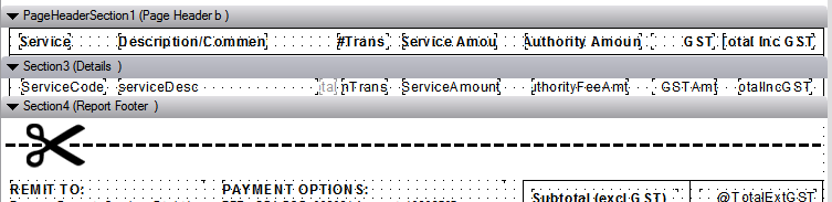

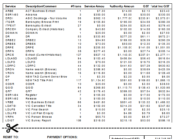

How can I show a line at the bottom of my detail section after the last record of the page? Depending on how many records, the line will need to appear at the end on each page to form a box around the detail output.
I have attached a portion of my design view and report preview.

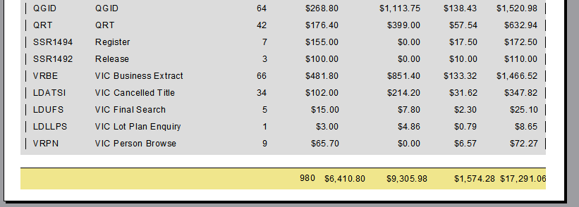

I have attached another printscreen. The grey colour is the background colour of the detail section and the yellow is the background of the page footer section.
i have also made the detail section higher so that it uses more room to make it simulate multiple pages, which is why the lines on the sides look odd.
thanks,
