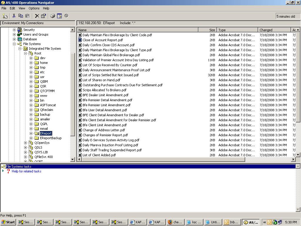

I have attached a print screen as below as to the location of the objects . I am trying to check programaticlly if a particular object exists or not in that dir as the files will be refresh everyday .

anuar8080:
You have --
    Dpathname         S             21
But the shortest path that I can see in the .JPG you posted is some 33 bytes in length. Even if a relative path is used, the shortest is 24 bytes (plus an extra byte for the null-terminator makes 25.)
Unless you supply a much longer pathname, it looks like you will always get "not found" because you cannot supply the full names.
