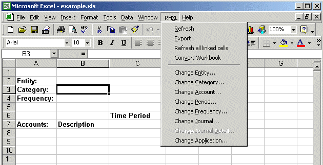

That's a legitimate concern, but do you know how I can get information on the methods in the rhxl32 add-in?

Is this the Hyperion Database addin?
Avatar of taduh
taduh
Yes
Avatar of taduh
taduh
Let me clarify - its the Hyperion Enterprise database - not Essbase.
You can't avoid flashing altogether, but if you leave screen updating off until after you have restored the control tab, it should be minimal.
In your code you have this line at the end of the report routine:
application.ScreenUpdating = True
That will cause a flash of the hidden tab.
Kevin
Avatar of alainbryden
alainbryden
Flag of Canada image
For the benefit of others viewing the question:
http://www.controller.iastate.edu/controller/hypdoc.pdf (Page 15+)

I guess if in enterprise there's no way to automate it, then you're stuck with this. You can't really dig into their protected addin methods. If they didn't provide a way to run their code through automation then you'll have to simulate the UI interactions.
Go with Kevin's solution and live with the flashing I guess. If you disable screen updating other than when you're activating new sheets, it will minimize the flashing like Kevin said.
I recommend that instead of referring to control 11 (since in the above example it's control 9) you should iterate through all the controls first, find the one with the name "RH&XL", and then call the first command.

I tried this to check the control, but it errors out:
If application.CommandBars(1).Controls(11).Name = "RH&XL" Then
Any ideas as to the appropriate syntax?
taduh
Avatar of taduh
taduh
Got it. It's this:
If application.CommandBars(1).Controls(11).Caption = " RH&XL" Then
